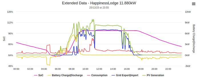

There is a bit more to it, as in PVOutput; you can submit consumption, generation, import, export, and in case a battery is in play, its charge, discharge and SoC can be recorded… to then produce a graph like this:
However, I use curl to submit the data once per 24h (usually 02:00), as real-time data is shown by openHAB.
