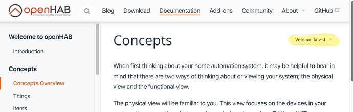

If you look at the 2.5 version of the docs, you won’t find that API. Note that you can select the doc version in the upper right corner of each page of the documentation.

@Kai @ysc @Confectrician Shouldn’t the default version of the documentation be “2.5” instead of “latest”? I don’t think too many people will notice the drop down at the top of the page. As a result they will be confused when they see features that are in the docs but don’t work.

Then it’s still confusing because the Version drop down contains options for “latest” and “2.5”. If “latest” is 2.5, then what is “2.5”
The Version drop down contains “latest” and “2.5”.
you are right this could be confusing.
Maybe we should rename that temporary.
Latest is 2.5.x which includes the patch release contents.
Ah, I see now. I was just thinking openhab-core, which is stuck at 2.5. So the 2.5 tag means the 2.5 release?
And now I understand why “latest” is there - to account for all the 2.5.x bindings, which will continue to change as PRs are merged.
Maybe it was the fact that the sendHttpGetRequest “latest” doc included a 3.0 change. But that was just a timing issue with the change to core versus the introduction of the versioning mechanism.
