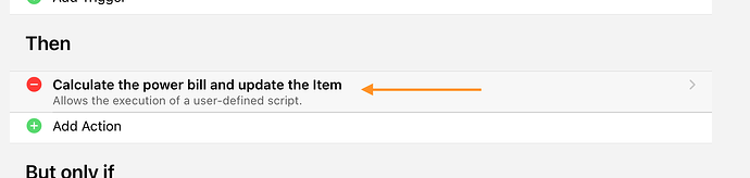

You added the line through the UI form or did you click on the code tab to add the line of code? I’d expect it to look like this:
Scripts are almost never just one line. Maybe that >- only appears if it’s more than one line?
If you are using UI rules, you really shouldn’t be editing the code through the Code tab. Click on the script action and you’ll get a nice code editor to enter your code.
The code tab is mostly helpful for sharing rules on the forum and getting help from the forum and stuff like that but it’s pretty miserable to use to actually enter the code for script actions and conditions.

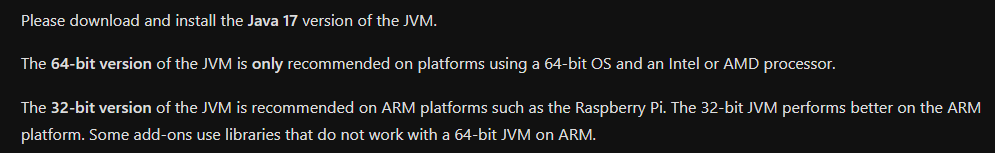

I have no reason to doubt you, but imagine you’re a new user, it’s your first attempt at OpenHab. You don’t know which version to download, so you go to Installation Overview | openHAB and you read this
yes, your right, this scares new users off. There had been long discussions about this issue and the statement now is already much weaker. The big disadvantage of 32 bit occurred after the introduction of the new java version.
My personal opinion is that a clear recommendation for 64 bit together with Pi4 or higher would be appropriate now. Rule development with Blockly or JavaScript is awful with the 15sec delay after every change. With 64bit you have a delay of 1-2sec before the first run so that’s completely fine.
