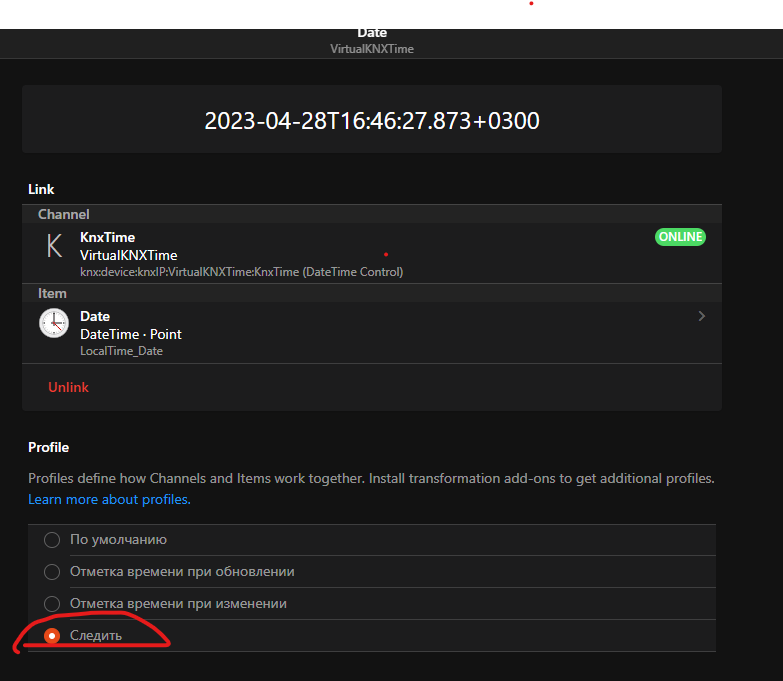

Like this (example for time control)
And don`t forget to put profile for knx channel to “Follow” to send event to knx bus
