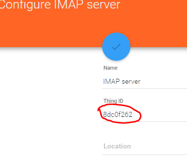

This kind of auto generated thing ID can be replaced by friendlier names when configuring from files, so mail:smtp:pairsmtp can be valid.
But yes, its a good idea for @dotat to look in PaperUI and see if the thing is as expected.
You can also change this name when you first create the Thing.
I personally wish it were required to change it rather than only optionally letting you change it. I highly recommend that for all manually created Things that users replace the auto generated ID with something meaningful.
