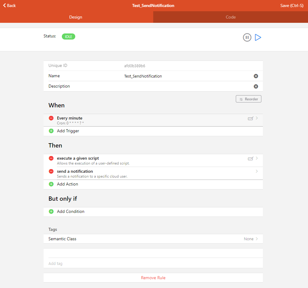

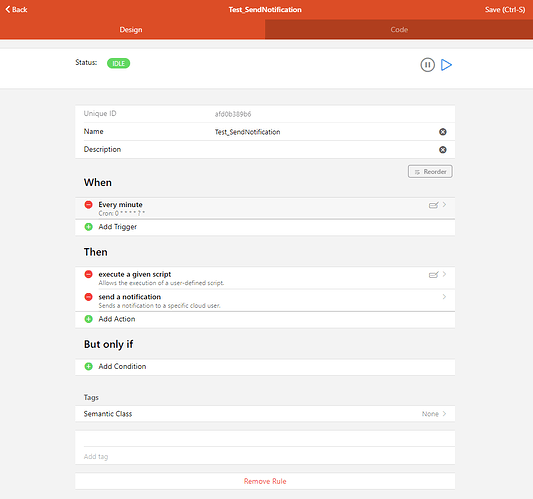

I’m struggling to get sendNotification to work inside a DSL script in a rule built using the UI. I’ve created a very simple rule that fires every minute and have added two actions: the first executes a one line script containing the sendNotification command and the second action uses the built-in UI ‘send a notification’ option. Both target the same email address (I’ve double checked this!) I get the message from the UI ‘send a notification’ but not the one from inside the DSL script.
I’m running OH 3.3.0 and recently restarted the cloud Add-on but that hasn’t helped. Here’s what the rule looks like:
And here’s what’s inside the script (email address changed):

Add back in the UI call to send the notification and see if the logs are different.
Ok, I set up the following:

  1. Rule defined in UI as before but with the UI notification set up as well as the DSL script notification as follows:

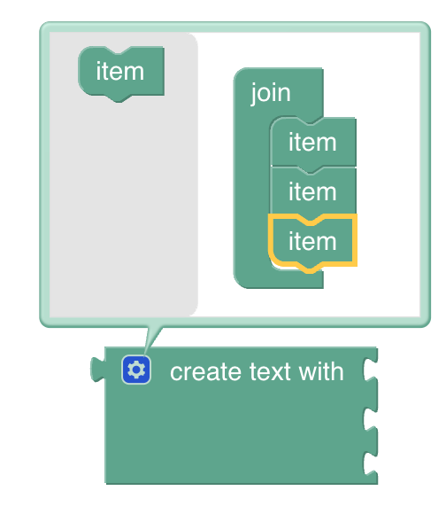

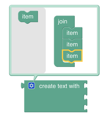

So if not using Rules DSL then how would you build dynamic text (i.e. based on the state of multiple items) to send as a notification message?
Under the “Text” category you’ll find a block that looks like this:
Click the gear and you can add “items” creating slots to append as many Strings together as you need.
