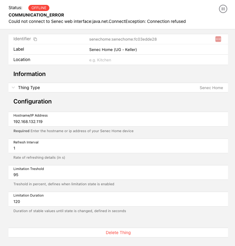

Since version 4.1.0, the Senec Cloud storage can no longer be connected. The IP address is correct, I just checked again.

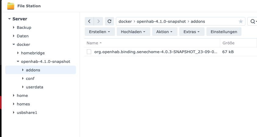

Download the Jar file and put it in the Addons folder.
Did you remove the “official” binding?
If the new SNAPSHOT is aktiv, you will see a new setting: useHTTPS this must be true.

@kl8ter Uninstalled the binding, loaded the file from you into the addon directory, rebooted from openhab, and then enabled https. Now everything runs again!
