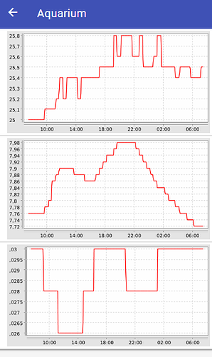

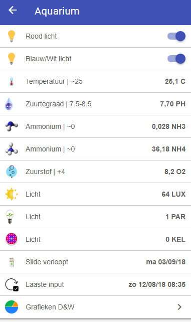

Seems it’s very important what you exactly typ
 :blush:
I had seneye:monitor:myseneye, and this didn’t work.
But seneye:monitor:mySeneye gives me better results.
Values are getting in perfectly now
 :wink:
Next step is writing some rules so I’m getting pushover messages when fe my temperature drops below 24, the PH goes above 8.5
I’m just wondering if we could also get the status about ‘in-out’ water? This can be very helpful when we’ve got a leak
 I can’t see this ‘status’ in the items/channels. But I’m getting a mail from Seneye if the sensor is out of the water. So somehow, they see this
Very Nice.
Just about to write that I now have it working, one thing I noticed is that you have to have an active slide.
Once your slide expires you just get error messages, you do not even get the basic information.
I like the charts, I think I need to set those up next:)
