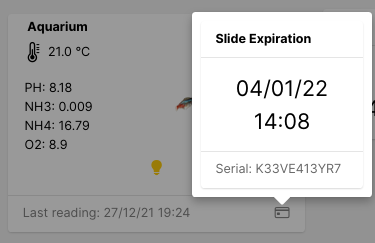

My first widget, based on the MiFlora widget. I’m not a programmer, so bear with me.
I’ve added most things linked with the seneye sensor. I hope they’ll all work. To be tested?
Some features:
  • Data is gather from the GUI Model page. So if you’re using the naming convention of the binding, you should be good. Just enter the name you used for you sensor, and it should work.
  • Values will show up if data is available
    You can notice fe the missing LUX, Kelvin… in my example, I don’t have this enabled. But I’ve put it in, so try it out.
  • All values are clickable, and will open the historical graphs.
  • Last reading will go red if data is older then 1 day.
    Gives you an idea that you should check your sensor.
  • Slide icon will change color/icon when replacement time is nearby. First orange, then red. You can also click the icon to see the more details about the date/serial.
    Can help you remember to replace/buy the slide.
  • The picture is transparant, and will go red if the sensor is out of the water.
    Cool feature on your dashboard? Of course, let’s hope you won’t need it!
  • An item can be selected to have fe the aquarium light ON/OFF.
You should copy the background image seneyeWidget.png to the html folder (/etc/openhab/html/). I’m thinking about to have it public somewhere in the future, so people don’t have to do this manually. Would be nice to have a global place for these kind of images.
Let me know what fails to work, or suggestions, improvements…
