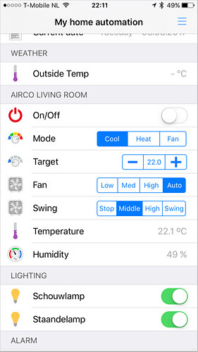

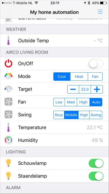

Hi Michael,
I’ve been tweaking the Sensibo Sky OH2 config files to include API supported Swing function. That works just fine on my AC. Selected only four modes, so it fits nicely on my phone screen.
Next to that I changed the Target icon to heating so it gets a dynamic colored knob. The same for the Humidity icon, changed it to hunidity and gives a colored gauge.
