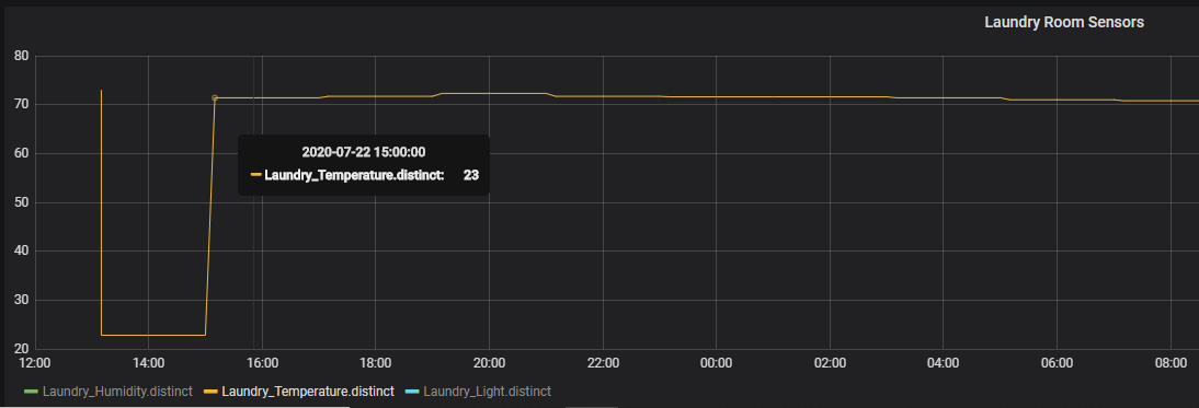

I recently purchased the Inovelli 4-in-1 multisensor, and have it correctly adopted to my z-wave network. The sensor seems to have initially transmitted celsius, and then changed to farenheit temperature data, based on the grafana data. This is for a variable I never had data coming into previously.

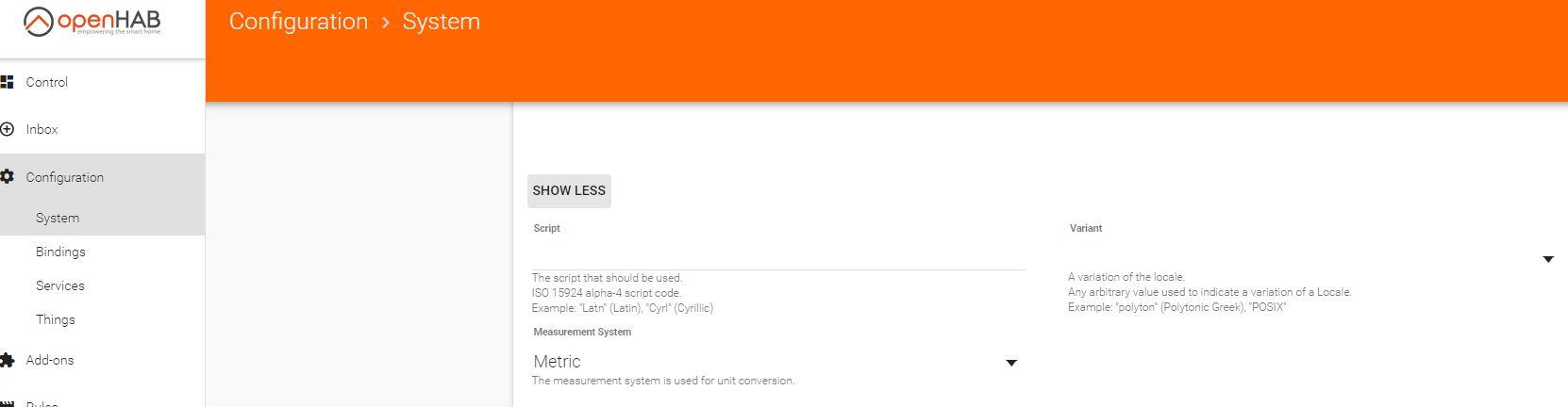

For others, in PaperUI:
Configuration > System > Regional Settings - CLICK [Show More] - then the option for metric/imperial is shown.
Cheers

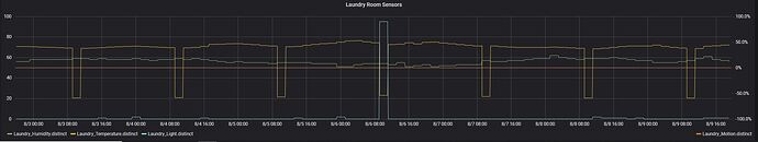

OK, so I’ve finally come back at this one as I have the switch ready to install to control the fan with some rules. As I looked at my recent data for the sensor, I noticed that the unit change issues persist.
Every day at 9AM, the sensor records in celsius, and at 11AM, it returns to farenheit.
This is quite odd, as I have not made any rules of any kind for this sensor yet - I’ve just defined an item in my files to effectively set the retention in influxdb.
I don’t have any rules anywhere in my setup that I am aware of that change units. With all my other devices, I have set them in the device settings to output celsius. The internally (to the sensor) calculated humidity doesn’t change, so it seems it’s on something downstream of the sensor date from that calculation.
Has anyone else used these Inovelli 4-in-1 sensors to know if they’ve had any problems like this?
Any other ideas of openahb cron processes (stock, that is) that may do something like this?

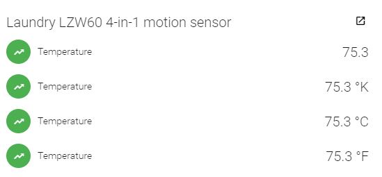

I have gone into my items file and set up a couple additional entries to see if they make a difference, as you’ll see below. TLDR: It doesn’t:
sensors.items
Number Laundry_Temperature "Temperature [%.1f °C]" <temperature> (gTemperatureItems) {channel="zwave:device:a204e4d4:node31:sensor_temperature"}
Number Laundry_TemperatureUndef "Temperature [%.1f %unit%]" <temperature> (gTemperatureItems) {channel="zwave:device:a204e4d4:node31:sensor_temperature"}
Number Laundry_TemperatureF "Temperature [%.1f °F]" <temperature> (gTemperatureItems) {channel="zwave:device:a204e4d4:node31:sensor_temperature"}
Number Laundry_TemperatureK "Temperature [%.1f °K]" <temperature> (gTemperatureItems) {channel="zwave:device:a204e4d4:node31:sensor_temperature"}
Current temp display, all showing same number, just different unit suffixes
And, the unit setting for OpenHab in PaperUI (at least, what I think is the correct setting)
So, it looks like setting a unit in the item definition, the way I did, doesn’t prompt a conversion. I’m eager to hear of a fix to how I define the temperature items.
