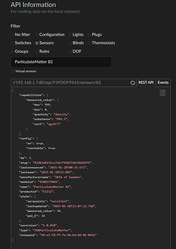

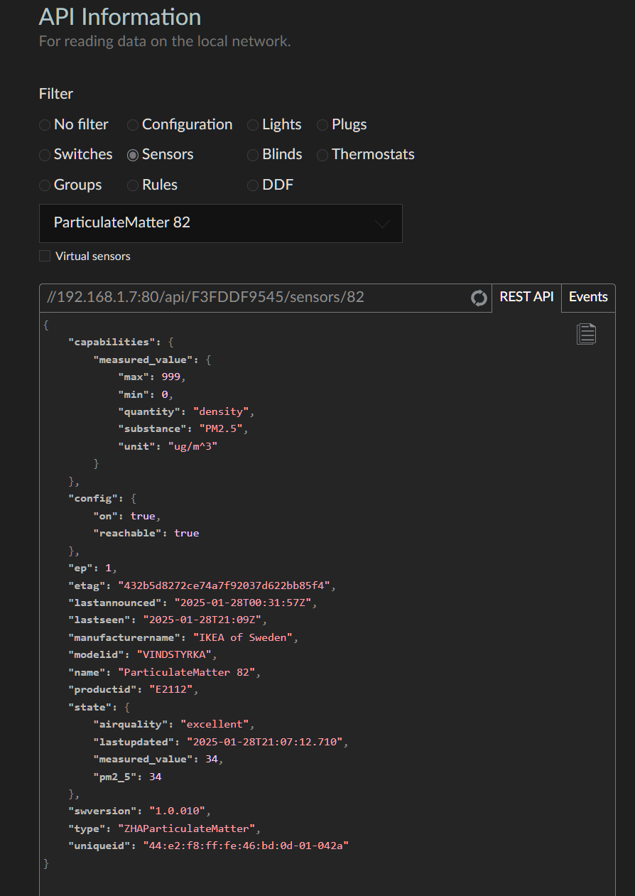

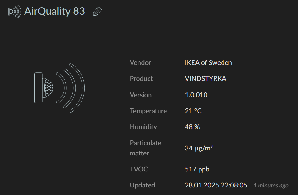

Just added an Ikea Vindstyrka Air Quality sensor in DeConz:
Temp, Hum and TVOC appears in the OH Inbox, but not Particulate matter:
Any ideas as to why this restapi sensor is not put in the OH Inbox?
Log says:
omr@shs2:~$ grep -i 'PM_air' /var/log/openhab/openhab.log
2025-02-20 07:08:41.955 [WARN ] [penhab.core.library.items.NumberItem] - Unit 'ug/m^3' could not be parsed to a known unit. Keeping old unit 'one' for item 'Vindstyrka_Air_Quality_Sensor_PM_Air_Quality_ppb'.
omr@shs2:~$
Could that have something to do with it?
