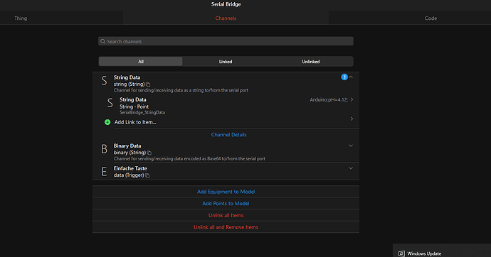

I have made a String Channel and an Item (picture 3) there you can also see the String i am sending. How do I use Role or where can I build a rule?

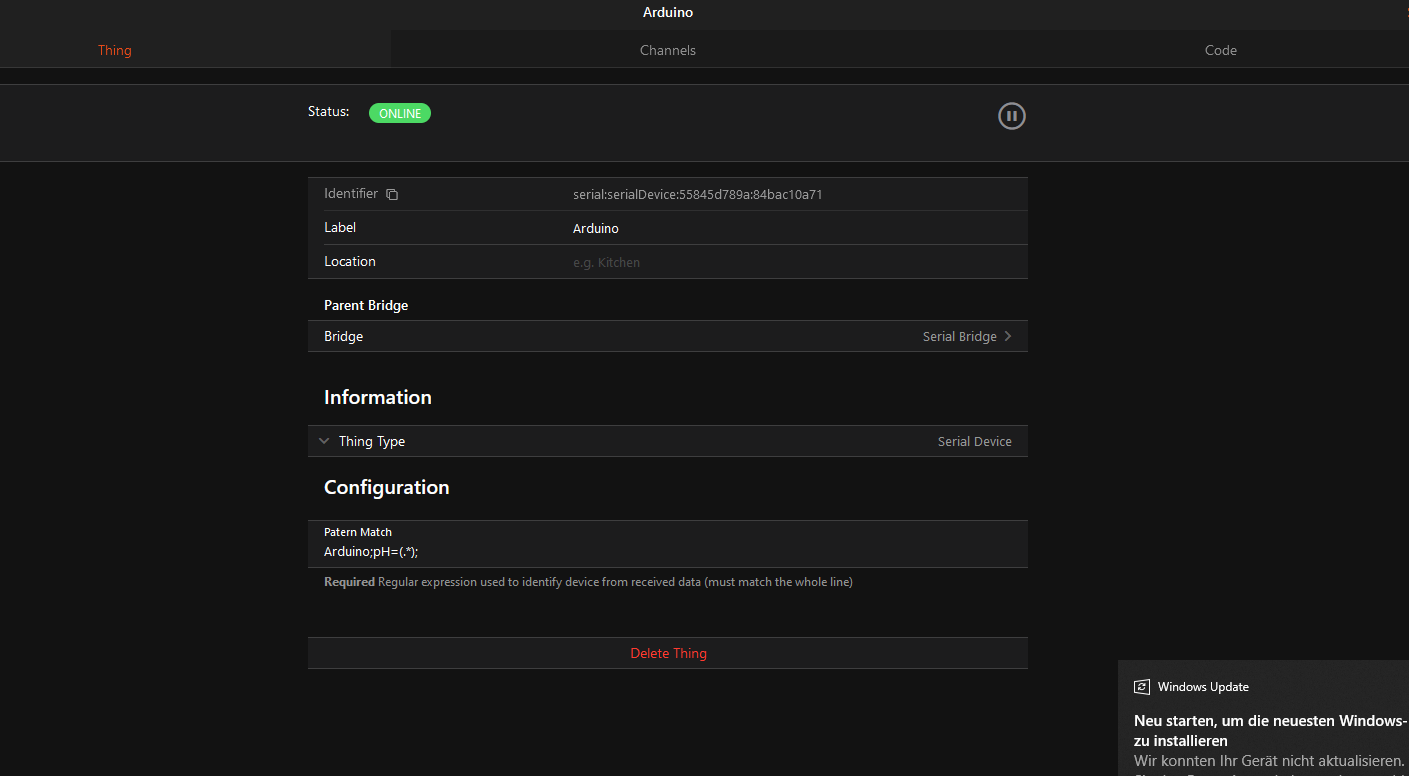

But in my Serial Device there is this Pattern match required, I think I already got there something wrong and I thought the stateTransformation parameter is only working with this RegEx transformation service.
Yes, but it has a transformation that does not work.

Screen shots are pretty useless for the most part. Please click on the “Code” tab and paste in the text you find there using code fences in the future.

But I was able to zoo in enough to see that your transformation string on the State Transformation is very incorrect, at least for how OH does REGEX.
Firstly, what’s with the [ ]? That’s nowhere in the docs and is very much unneeded. In fact, there is a REGEX example in the description of that field and you see no [ ] surrounding the string there.
Secondly, in OH a REGEX follows two rules.
The expression must match the full String of the message. Even if the String is a full web page, the expression must match the entire web page, not just a single line.
Only the first matching group gets returned.
You are following rule 1 but not rule 2. You have two matching groups, one that matches everything and the other that matches the digits.
Another problem is you’ve unnecessarily escaped the \. You don’t need to do that in the UI typically. The value is escaped for you. So the \\d is probably looking for the string “\d” rather than trying to match a digit.

I’m pretty sure there should not be a space between the : and the start of the expression. It’s going to look for strings that start with a space if you do that.
I removed, the space in the expression and checked again if the Add-On is installed. Everything is fine but still no result. The Item shows me always the value NULL, maybe I need to edit something in the Item configurations. The type of the Item is String. What kind of Informations could I send you to find the mistake.
I did such a stupid mistake… I was trying to write the stateTransformation into the serial Device, I wrote the expression now into the String Data Item and it worked.
