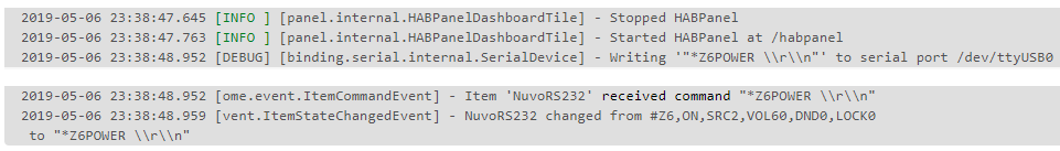

but it seems to be doing absolutely nothing apart from writing the below in the log file:
Is there something very obvious i might be missing? I have seen people using rules etc to control serial but to be honest i can’t understand why and if i need rules and a sitemap if all i want to use is HabPanel. Obviously i might be missing something very obvious, so i would appreciate any help :slight_smile:
Because you may not be able to do it all just from HABPanel.
What you need to do is send a command to this Item, or some other Item that consists of that String.
If you need to do just simple ON/OFF, create a Switch Item and configure the On and OFF transformation as described in the binding docs.
Sometimes there isn’t just a simple translation like this possible so users write rules to convert, for example, 50% set to a Dimmer Item to the String that needs to be sent you the serial device.

I wrote a native binding for the Nuvo GC & Essentia G. It is not merged in to the mainline yet… But you can find the jar here if you want to try it out: https://github.com/openhab/openhab-addons/pull/7651
