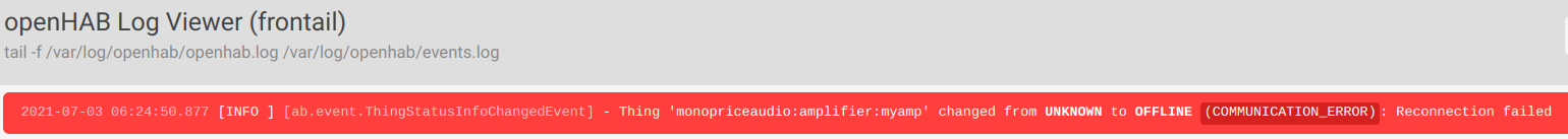

Issue of the topic: I am using the Monoprice WHA binding , I have setup the configuration according to the instructions, but I cannot manage to obtain serial connection to the Monoprice 10761.
//serial port connection
monopriceaudio:amplifier:myamp “Monoprice WHA” [ serialPort=“/dev/ttyUSB0@9600”, pollingInterval=15, numZones=6, inputLabel1=“PA”, inputLabel2=“Kitchen”, inputLabel3=“Office”, inputLabel4=“Master Bath”, inputLabel5=“TV”, inputLabel6=“Phono”]
I have added openhab to dialout sudo adduser openhab dialout in case that was the issue. Also, restarted my RPi and the amplifier. Still no luck. I would appreciate any ideas.

remove @9600 from your configuration.
The serial port interface is configured in the binding itself.
Code snippet:
SerialPort commPort = portIdentifier.open(this.getClass().getName(), 2000);
commPort.setSerialPortParams(9600, SerialPort.DATABITS_8, SerialPort.STOPBITS_1, SerialPort.PARITY_NONE);
commPort.enableReceiveThreshold(1);
commPort.enableReceiveTimeout(100);
commPort.setFlowControlMode(SerialPort.FLOWCONTROL_NONE);
InputStream dataIn = commPort.getInputStream();
OutputStream dataOut = commPort.getOutputStream();
srgoebel
(Stephen)
July 3, 2021, 2:04pm
3
It worked! Thanks for your help.
