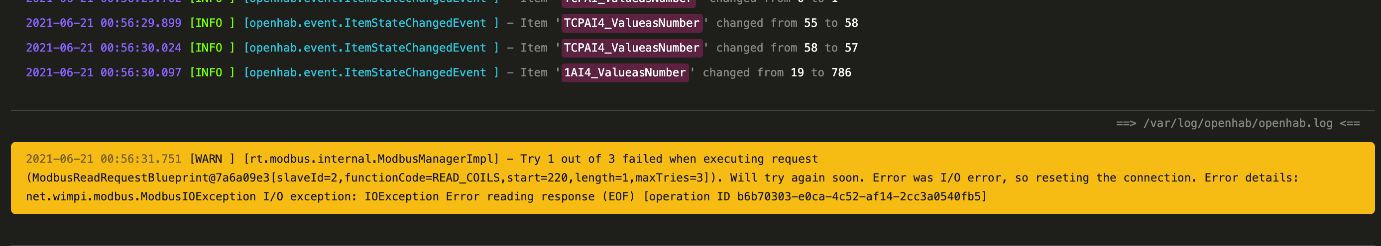

i am using Modbus binding on Raspberry PI4 (Openhabian 3.0.2) with RS-485 to USB convertor , it work great with no issue but i have noticed sudden crash for Openhab quite often now which means openhab stop working or responding at all and USB stop communication to modbus salve devices .
finding :
- when i have error in log for modbus RS-485 communication (via USB convertor) the crash happen and when i have more error the crash happen faster.
- when crash happen openhab stop responding and logs are freezes while i still can access SSH and reboot Raspberry PI.
any help please
