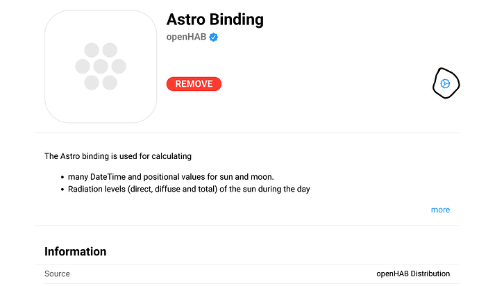

First, for the logging level of bindings you can set the level by navigating to Settings → Bindings → Binding Name and click the little gear icon in the upper right or through the REST API or through the Karaf Console, or by editing log4j2.xml.
Unfortunately the REST API doesn’t support changing any other logger’s logging level so you’ll have to change those using the Karaf console, or by editing log4j2.xml and adding a new Logger to the bottom and setting the level there.

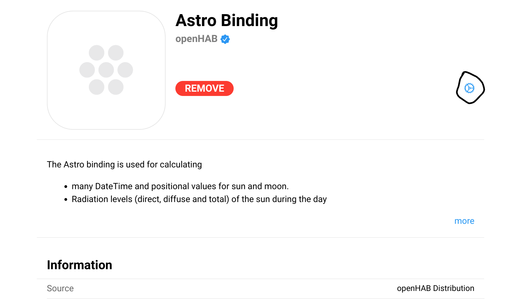

I’m on OH 3.4.2 but do not see a gear icon. Is it a later addition?
I’m pretty sure it was included in 3.4 but maybe not.
The gear icon might have been introduced earlier for binding configs, but setting log levels was just recently merged into 4.0
OK thanks, that’s why I don’t have it.
