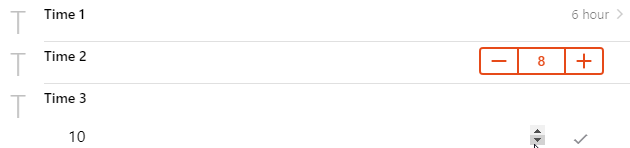

I would like to set the start and end time of an equipment within the UI Homepage .
If I take a Number:Time “Time1” item I cannot set any value (is it a bug?).
If I take a Number:Temperature “Time2” item I can set very nicely a value but with the wrong dimension.
If I take just a Number “Time3” item I can set a value but the min and max limits are not taken into account (strange behaviour).
I would like to do it as it is done for temperatures.
Is there any proper solution available for setting of numbers within the Homepage? I don´t want to use widgets for this case.
Thank you for your help, Franz
Number:Time         Time1       "Time 1"     ["Setpoint"]       {stateDescription=" "[ pattern="%.0f",min="0", max="24", step="1" ]}
Number:Temperature  Time2       "Time 2"     ["Setpoint"]       {stateDescription=" "[ pattern="%.0f",min="0", max="24", step="1" ]}
Number              Time3       "Time 3"     ["Setpoint"]       {stateDescription=" "[ pattern="%.0f",min="0", max="24", step="1" ]}
This is the result in the Equipment Homepage:
Not exactly sure what you want to achieve, but if you want to get a time, number is the wrong item type (also not sure why it should be number: temperature?).
There is a dedicated datetime type you should better use.
For widgets you can use the f7 input type “time” and can also adjust the state description to only show the time part and not the date part.
You will also be able to trigger rules based on the time of your item.
Do you mean a duration when you are talking about “time” (e.g. 2 hours). Or are you referring to an instant in time (if so see @Matze0211’s answer).
Assuming the former…
I take this to mean you want either a slider or a setpoint widget to change the value.
The widget chosen by default depends on the Item type and the semantic tagging. If you are using the semantic model, this Item is most likely to be a Point, not an Equipment. So I would expect two tags for this Item, not just one. Probably “Setpoint” and “Duration”.
But that’s no guarantee that the correct widget will be chosen by default. It makes a best guess but doesn’t always get it right. This is why the default widget Item metadata exists. You can set the desired widget you want to have shown on the Overview Pages by setting the “default list item widget” to define exactly how you want it to appear.

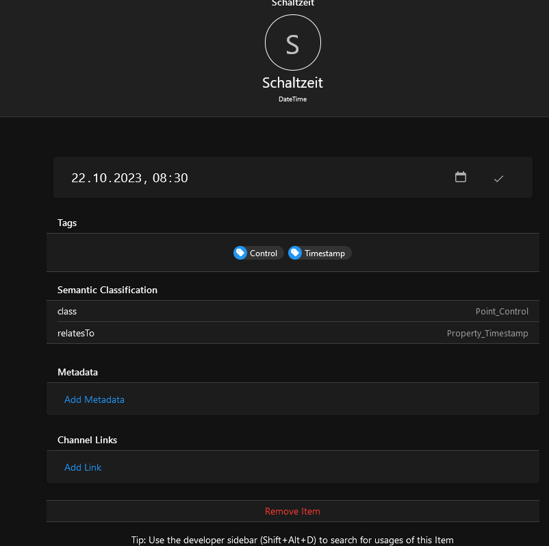

Franz,
had to solve a similar task -program a (OSRAM) switch with start time, end time and duration.
I did it using the widgets on a page which looks like:
The item looks like e.g.
and the resulting code for the page is:

                  title: Ausschaltzeit
                  type: datetime-local
                  useDisplayState: true
