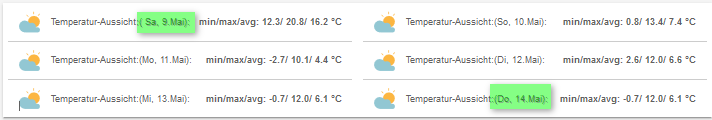

ir.getItem("localDayTempForecast_{}".format(day_count)).setLabel(u"Temperatur-Aussicht:({:>10}): [%s]".format(DateTime.now().plusDays(day_count).toString("EE, d.MMM")))
The command changes the Label of an item, but there is no refresh in the sitemap only if I made it manually via browser.

When the script is triggered sitemap shows:

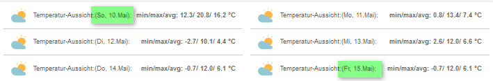

When making a manual refresh of the sitemap, I get:

It’s an undocumented function, the UIs don’t listen for label changes.

There’s no problem with the code. The code is doing as expected, changing the Item label text.
Your problem is the UI doesn’t know or care that it changed.
I don’t expect it’ll be any different in OH3, it might.
In order for this to work as you wish, several things would have to happen -
openHAB core would have to create a new event signalling Item label change.
Every UI would have to be modified to listen out for the new events and update display.
thx again.
It’s a pity. But then one can’t do anything. I thought so. Even if I first made the change of the label and then update the item’s value.
So I have to think about to do it like Scott does in his owm.py script. Where he removes and recreates those items “on the fly” and not using items of a textual configuration. But at the moment this is too big stuff for me.
