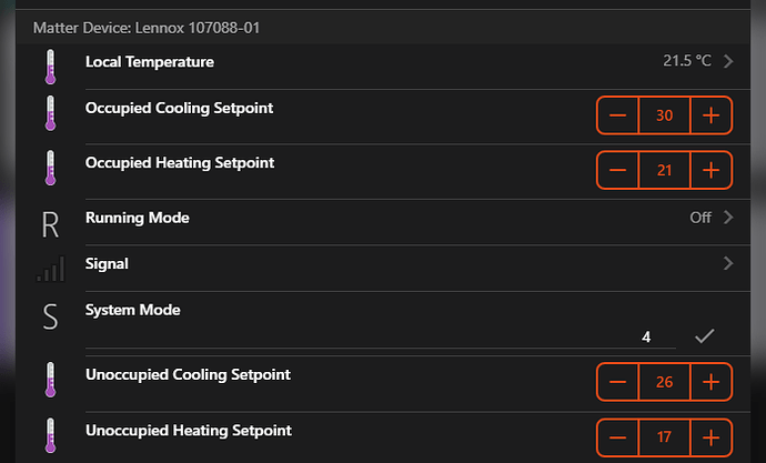

And here is a screenshot of the Equipment it created
Signal has no data
Running Mode is always OFF but the HVAC is operating
It’s not clear what system mode is

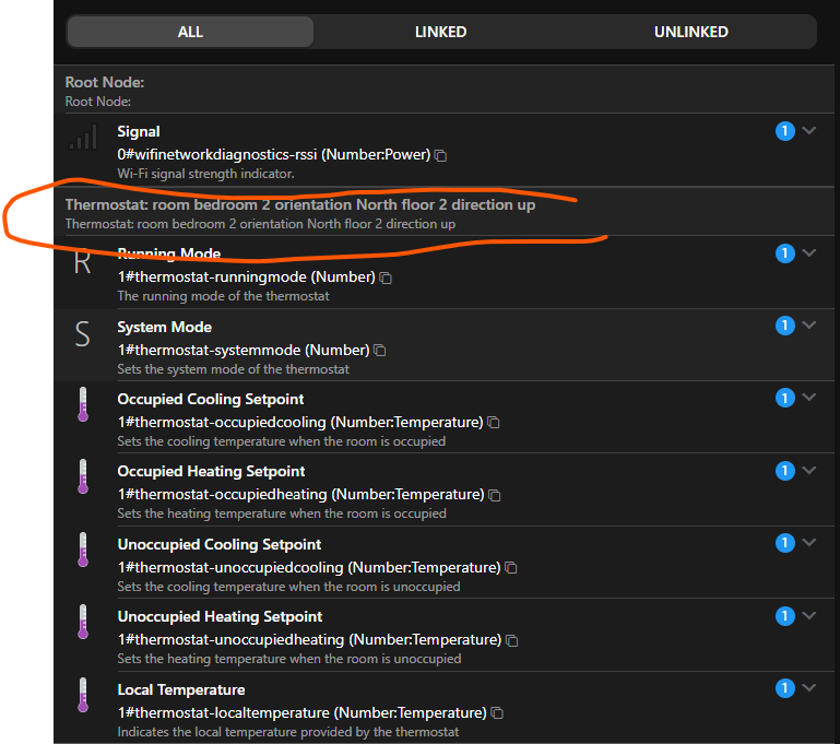

Here are the Channels in the Thing with some strange data (circled)
There is no documentation from the vendor.
I’m assuming the way it appears in OH is because of their implementation?
