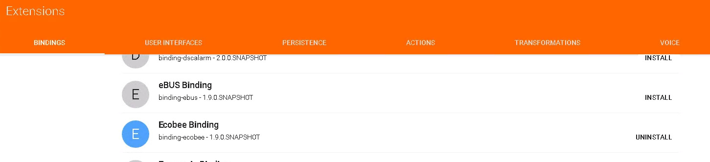

Extenstions
show ecobee binding installed:
But in Configuration > Bindings
, there is no ecobee binding shown:
There is no ecobee in Configuration > Things
either.
Where do I find it?
@dapanda, Please see above linked topic. This ought to get you past the issue.
