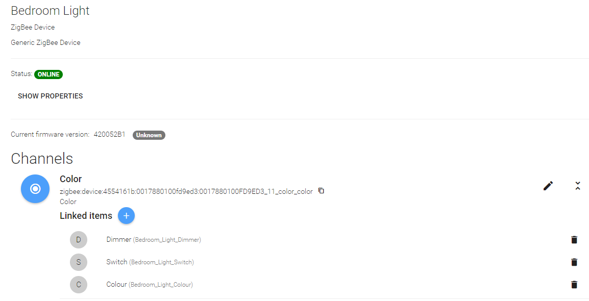

thanks for the tutorial. I’ve started using OpenHABian and followed the beginners tutorial in the docs. But I am a little bit confused if I should configure things in Paper UI or in textfiles to also have it available in the Basic UI.
I configured Philips Hue in Paper UI. Works great, easy to configure. Then I wanted to adjust my sitemap for basic UI. Do I really have to configure everything again textbased (.things file, .items file and .sitemap)? Because if I do that these configs also affect the Paper UI and I will see i.e. the Hue Bridge twice. Also the lights which I configure are visible again in the other tab in Paper UI.
In my opinion the things and items are already configured through Paper UI - I only want to have it visible in Basic UI. What did I misunderstood here?
Best regards,
Andy
Only the sitemap needs to be in a textual format. It can refer to the items that you’ve made in paper UI.
sitemap default label="Main Menu"
Text label="Bedroom" icon="bedroom"
Frame label="Bedroom Light"
Switch item=Bedroom_Light_Switch
Slider item=Bedroom_Light_Dimmer
Colorpicker item=Bedroom_Light_Colour
Hmm I thought that I’ve tried that…but now it works!
Thank you!
