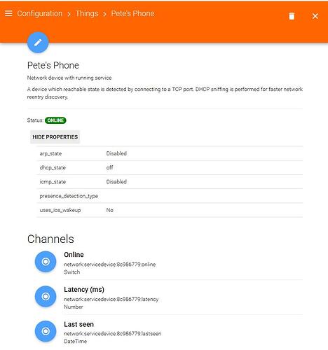

Could you please post a screenshot of your item configuration? Click the edit button on top of your phone thing
I believe this is what you asked for.
No, I meant the configuration screen after you click on the crayon icon = edit button

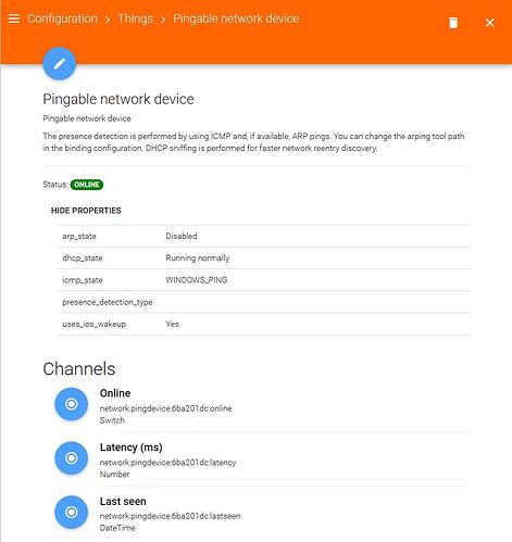

Ah, I was just wondering why your channels have the string “servicedevice” in it. Is it possible that you added your phone with the “Network device with running service” option instead of the “Pingable network device” option? You would need a running service like a webserver on your phone in order to make it work.
Please try to remove your phone (trashcan icon on your screenshot) and add it through the “Pingable network device” option: Inbox → Search for things → Network Binding → Add manually → Pingable network device; then enter your phone’s IP address
OK, I deleted my phone and used pingable this time. Now I have the first image below. Then I went to Control and I get the second image. Recall, I really don’t know what I am doing. I was just stepping through a tutorial (that I think was obsolete) tying to reproduce the screens in the tutorial. As I recall the tutorial showed the phone was Online but mine shows not Online.
