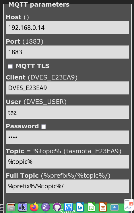

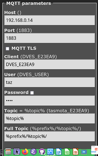

Your screeshot say that tasmotaHub is the Topic
but in your thing zPlug1 is your topic, this can`t work
show the output of the tasmota conole, you sayed that it works, then will see what is the topic and the device!!!
TasmotaHub is what I thought was the name of the bridge. Should that field be empty?

41picX is your mqtt topic
if you want to change the topic you have to change the mqtt settings %topic% to whatever you want
