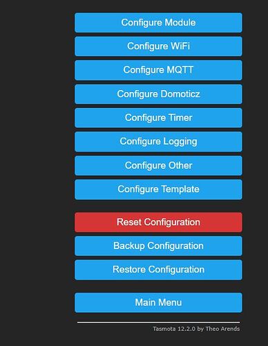

I made backups from each of my tasmota devices, at the moment 30+ plus 2 zigbee coordinators,
Never lost config through power fail or out of the blue, when i lost config it was user error, restoring was never a problem!
Backup

Try and restore that configuration backup onto another Sonoff Bridge and see if it will start the coordinator and recover all the devices you have configured.
That configuration certainly transfers the WiFi settings etc - but not the devices…
The designers confirmed that it wasn’t possible. (You will find a thread on the Github for the Z2T project.

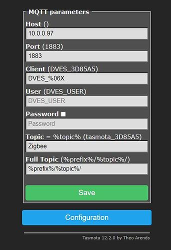

I wonder if you ever came across this site with lots of informations about how to.
Understanding Zigbee messages
Sending Device Commands
MQTT command example
But first of all you should understand how the MQTT topic works
mqttTopic
In my case Zigbee is the topic which i set in the mqtt settings.
You can find this topic again in the output of the console
tele/Zigbee/Lamp/SENSOR = {"Lamp":{"Device":"0xFB7F","Name":"Lamp","Power":1,"Endpoint":1,"LinkQuality":44}}
you can see now Zigbee is the topic and Lamp is my device
The state topic for Power should now look like this
stateTopic: tele/Zigbee/Lamp/SENSOR
transformationPattern: JSONPATH:$.Lamp.Power
and the command topic shoul look like as described here
commandTopic="cmnd/Zigbee/Lamp/ZBSEND",
formatBeforePublish: "{\"device\":\"Lamp\", \"send\":{\"Power\":\"%s\"} }",
on="1",
off="0"
and this
setoption112 1

In the warn log you can see that your path is wrong
2022-12-19 21:31:22.033 [WARN ] [t.generic.ChannelStateTransformation] - Executing the JSONPATH-transformation failed: Invalid path '$.POWER' in '{"zPlug1":{"Device":"0x8BAD","Name":"zPlug1","Power":0,"Endpoint":1,"LinkQuality":66}}'
the transformationPattern should be
transformationPattern="JSONPATH:$.zPlug1.Power",
and your mqtt broker is talking to the tasmota topic and not directly to your device, so you only need Zigbee without zPlug1

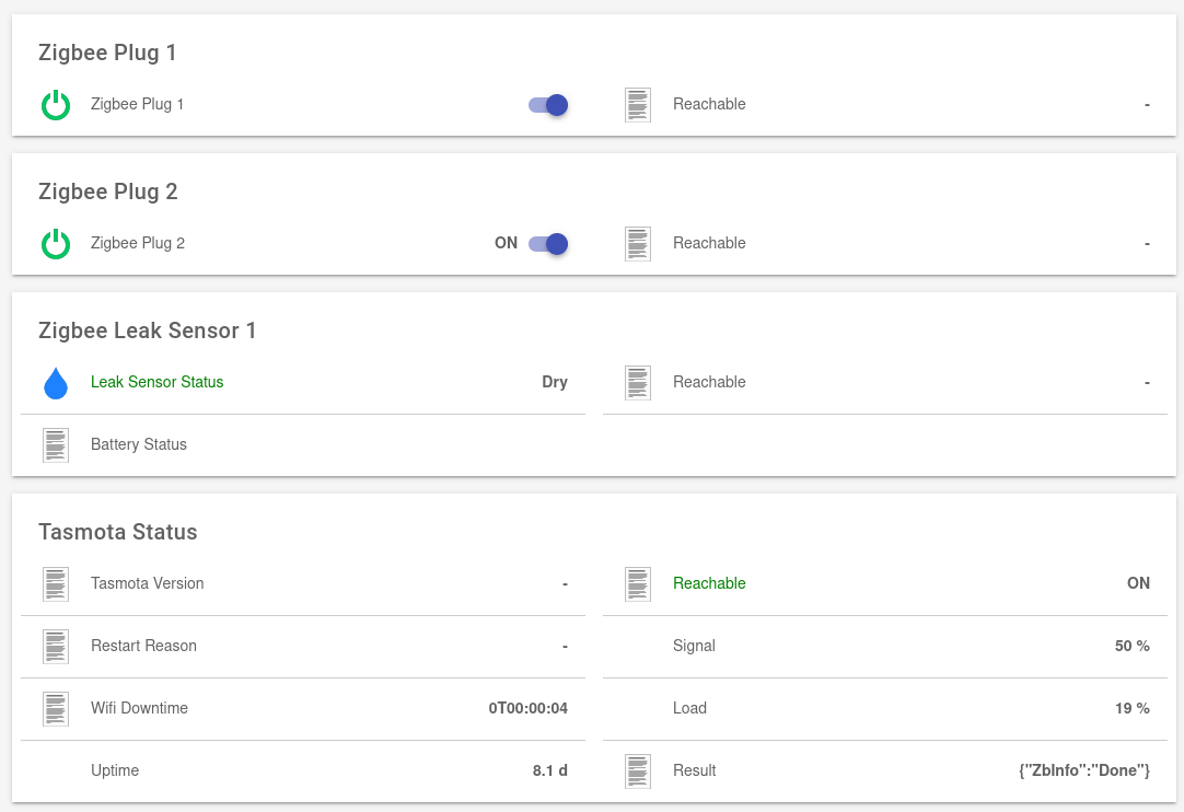

SO, I have it mostly working. The switches operate and the leak sensor sends alerts. I am still working on getting devices to report status - things like reachable and battery level - but at least I have basic functionality.
Here is my code, such as it is:

and here’s what I’m seeing in the basic UI:
Thanks for everyone’s help. I’m still trying to get my head around some of the tasmota idiosyncrasies, but at least I know it’s doable!
What is still not working?
I can’t get the devices to report reachable. So long as the device is reporting its on/off status, I think that tells me if it is reachable or not.
