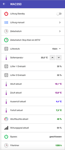

Creating the data Things automatically makes various channels available for your Items.
At this stage, you should be polling your Westaflex over Modbus error free.
To make the data available to openHAB rules and Uis, you must link Items to the Modbus channels.
westaflex.items
Group WAC350_Sensors "Westaflex sensors"
Number Zuluft "Zuluft [%.0f]" (WAC350_Sensors) { channel="modbus:data:winputA:wi00:number" }
Number Abluft "Abluft [%.0f]" (WAC350_Sensors) { channel="modbus:data:winputA:wi03:number" }
Number Fort_Luft "Fortluft [%.0f]" (WAC350_Sensors) { channel="modbus:data:winputA:wi06:number" }
Number Aussenluft "Aussenluft [%.0f]" (WAC350_Sensors) { channel="modbus:data:winputA:wi09:number" }
Number Abluftfeuchte "Abluftfeuchte [%.0f]" (WAC350_Sensors) { channel="modbus:data:winputB:wi13:number" }
Number Bypassklappe "Bypassklappe [%.0f]" (WAC350_Sensors) { channel="modbus:data:winputB:wi14:number" }
Number Luefter1 "Luefter1 [%.0f]" (WAC350_Sensors) { channel="modbus:data:winputB:wi15:number" }
Number Luefter2 "Luefter2 [%.0f]" (WAC350_Sensors) { channel="modbus:data:winputB:wi16:number" }
Number LuefterStufe "LuefterStufe [%.0f]" (WAC350_Sensors) { channel="modbus:data:wholdA:wh00:number" }
Number ZuluftTempSet "Solltemperatur [%.0f]" (WAC350_Sensors) { channel="modbus:data:wholdA:wh01:number" }
Number FilterTimer "Filter Timer [%.0f]" { channel="modbus:data:wholdB:wh305:number" }
Switch FanStandby_Switch "FanStandby_Switch" { channel="modbus:data:wcoil:wc17:switch" }

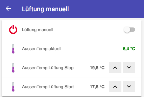

rule "Aussenluft manuell"
    Item AussenTemp changed // your outdoor temp sensor
   if(Lueftung_min_max_Temp.state != ON) return;  // wenn Schalter aus(nicht an) , keine Aktionen
   if(!(AussenTemp.state instanceof Number)) {
        logWarn("Lüftung manuell", "AussenTemp.state not a Number: {}",AussenTemp.state)  // numerisch ?
        return;
   if (AussenTemp.state >= AussenGrenzMax_Set.state && FanStandby_Switch.state != OFF) {
       // above max limit
       FanStandby_Switch.sendCommand(ON)
       logInfo("Lüftung manuell", "LuefterStufe ist jetzt: {} AussenTemp beträgt {}",LuefterStufe.state,AussenTemp.state )
   else if (AussenTemp.state <= AussenGrenzMin_Set.state && FanStandby_Switch.state != ON) { // below min limit
       FanStandby_Switch.sendCommand(OFF)
       logInfo("Lüftung manuell", "LuefterStufe ist jetzt: {} AussenTemp beträgt {}",LuefterStufe.state,AussenTemp.state)

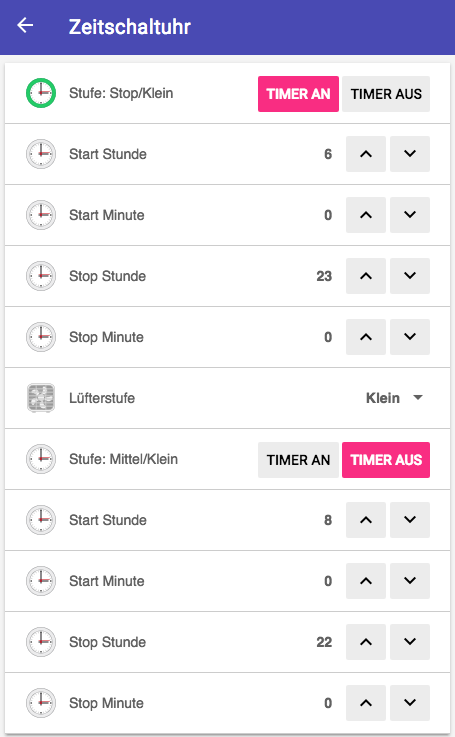

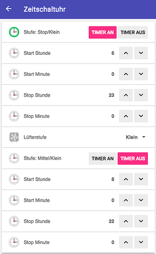

rule "Wecker Deko"
        Time cron "0 * * * * ?" //Abfrage jede Minute
    if(WAC350_Zeitschaltung_01.state == ON) {
        var sollMinute = (Deko_WECKER_M.state as DecimalType).intValue
        var sollStunde = (Deko_WECKER_H.state as DecimalType).intValue
        var sollMinuteo = (Deko_WECKER_Mo.state as DecimalType).intValue
        var sollStundeo = (Deko_WECKER_Ho.state as DecimalType).intValue
        if (sollMinute == now.getMinuteOfHour && sollStunde == now.getHourOfDay) {
            LuefterStufe.sendCommand(1)
        } else if (sollMinuteo == now.getMinuteOfHour && sollStundeo == now.getHourOfDay) {
            LuefterStufe.sendCommand(0)
    if(WAC350_Zeitschaltung_02.state == ON) {
        var sollMinute = (Deko_WECKER_Ma.state as DecimalType).intValue
        var sollStunde = (Deko_WECKER_Ha.state as DecimalType).intValue
        var sollMinuteo = (Deko_WECKER_Maa.state as DecimalType).intValue
        var sollStundeo = (Deko_WECKER_Haa.state as DecimalType).intValue
            LuefterStufe.sendCommand(2)

Here a few Screenshots of my UI:
