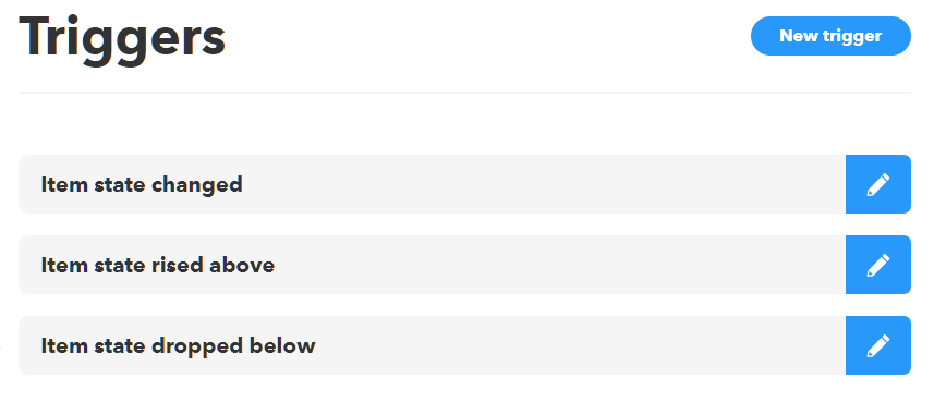

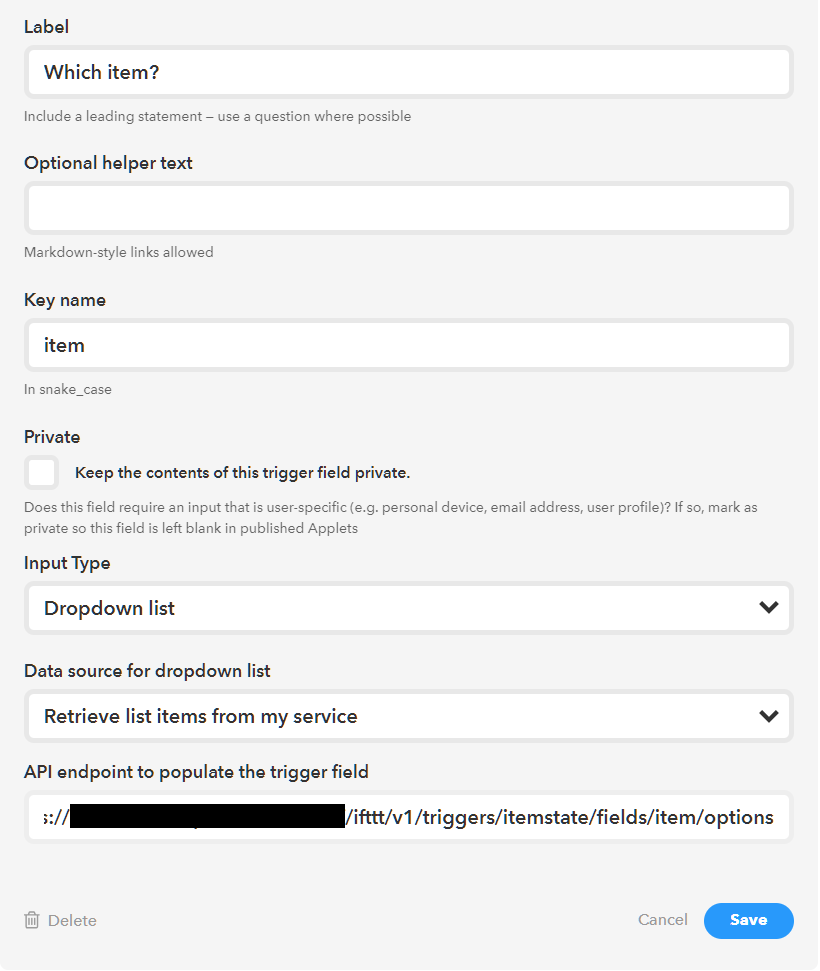

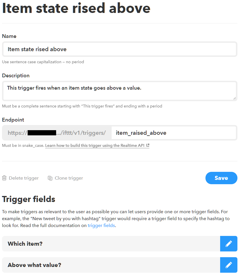

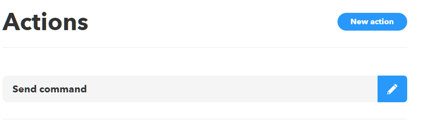

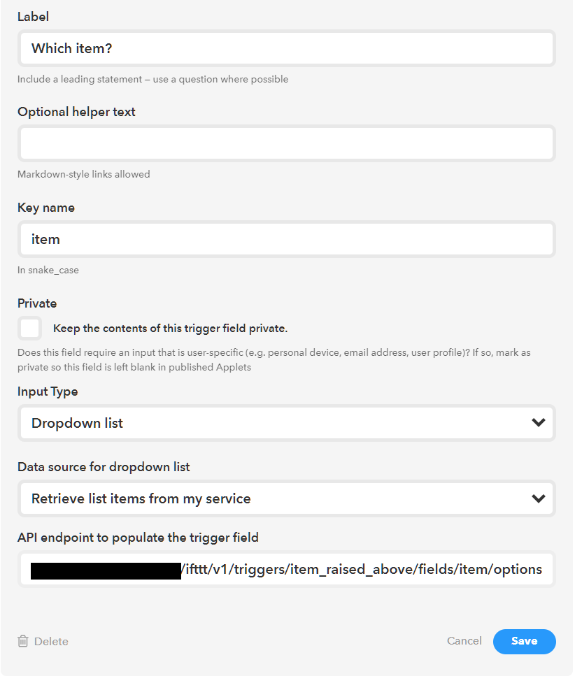

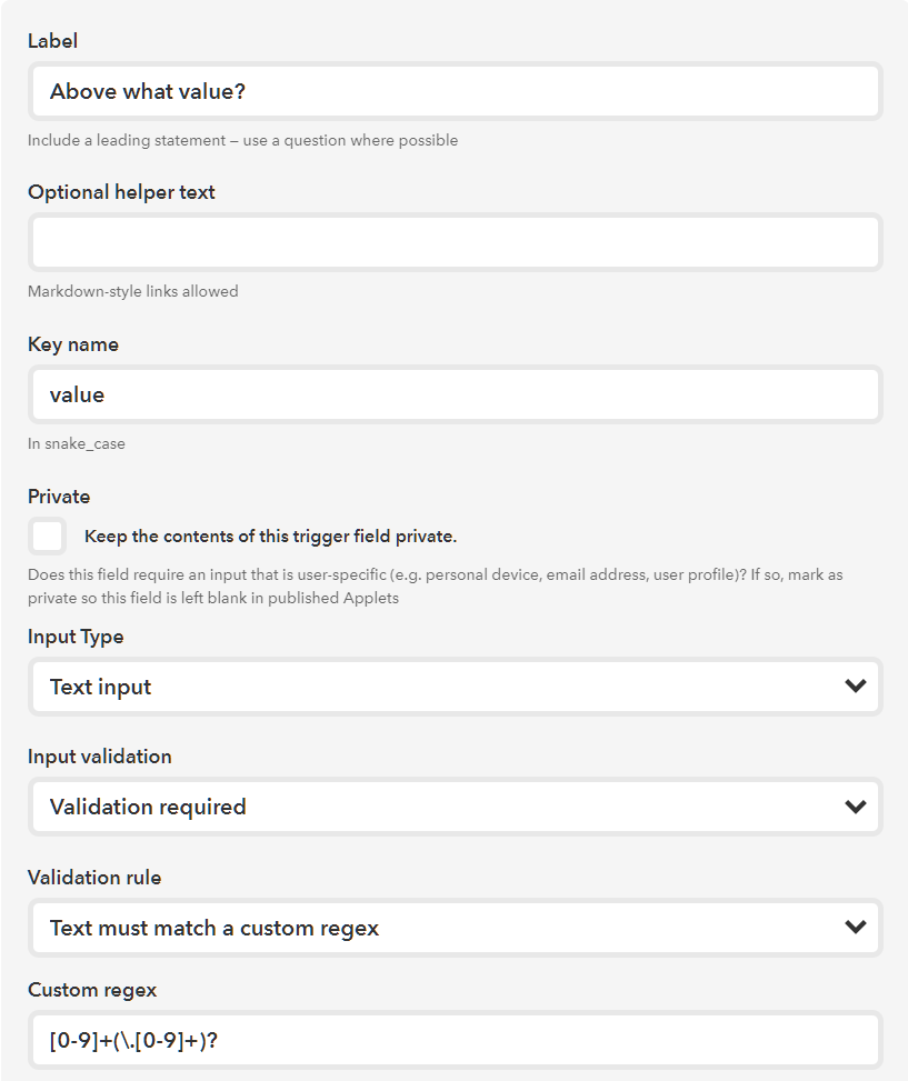

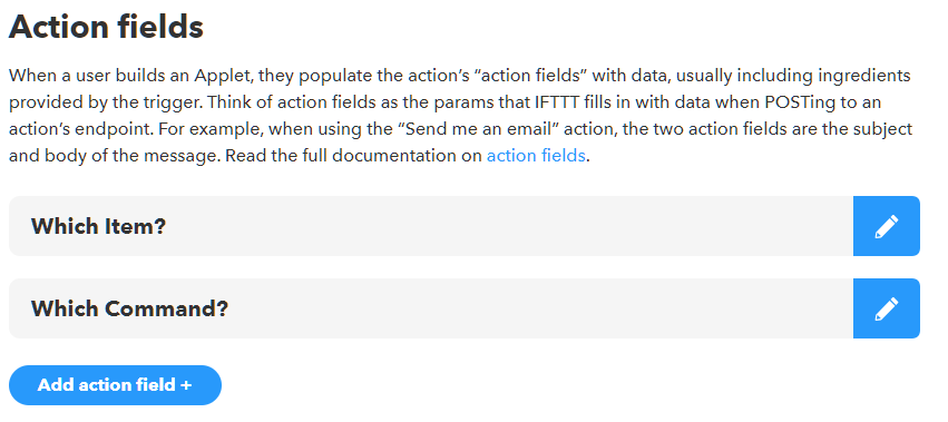

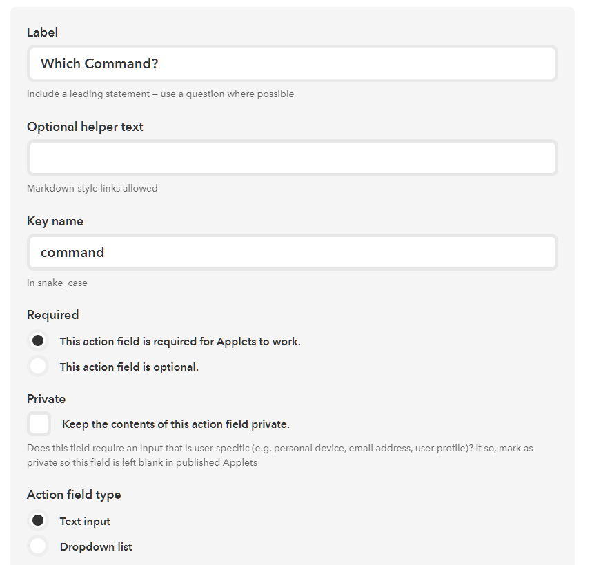

I am not using IFTTT anymore (too unreliable for geofencing, which was what I mostly wanted it for), but here some snapshots of the API config I was using, in case it is useful to somebody. It is probably not the best in the world, and can be surely improved
My IFTTT API configuration for custom OH Cloud instance:
