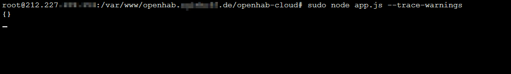

There should be no space between the dashes and the ‘trace-warnings’:
sudo node app.js --trace-warnings
sorry, my mistake - i tried again, but no changes:
is it normal that the command “keeps running” and i cant enter the next command?

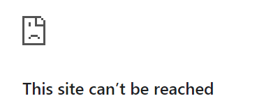

However, I am only able to access the instance using the IP Address of my server but no domain name.
I am able to access the default nginx site on https without any issue but just when I try to open the site with 3000 as port, it won’t show up and throws the error:
Am I missing anything here?
