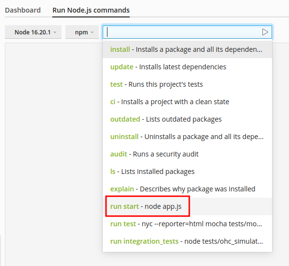

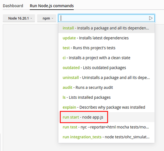

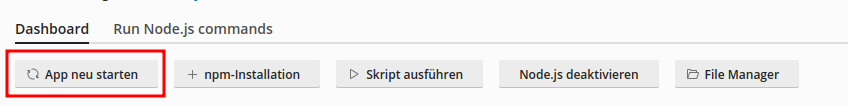

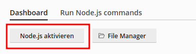

After pulling the git repo you will find the node dashboard with the option to “activate node.js”
After clicking that button the website was available and I had the option to restart the app.
But after your comment
I started to look further and there is a tab to run Node.js commands
nodejs_run_commands
and there was the possibility to start node
Now a node instance is listening on port 3000
listen
and the configuration provided above works like it is.
