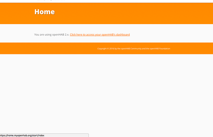

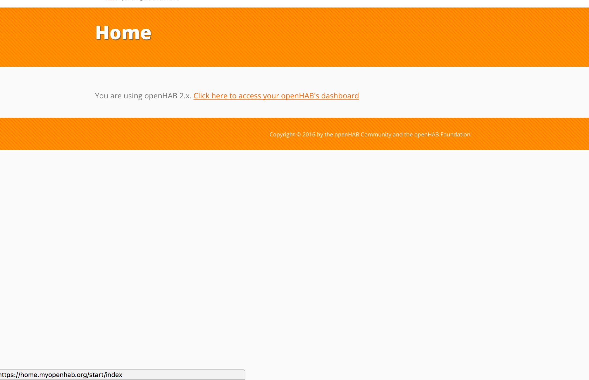

Followed your guide… got my openhabcloud running in under 30 minutes!
Thanks… only thing i noticed is that when trying to access my dashboard it still refers to home.myopenhab.org instead of my private url… I think i noticed a topic around this already… let’s see if we can fix this :slight_smile:
Could you explain this a little more, I don’t see this.
the link towards the dashboard “Click here to access your openhab’s dashboard” still points towards home.myopenhab.org (lower left corner) whilst i would expect this to point to my private url.
Is my understanding correct?
Got it, fixed it in this patch if you’re interested.

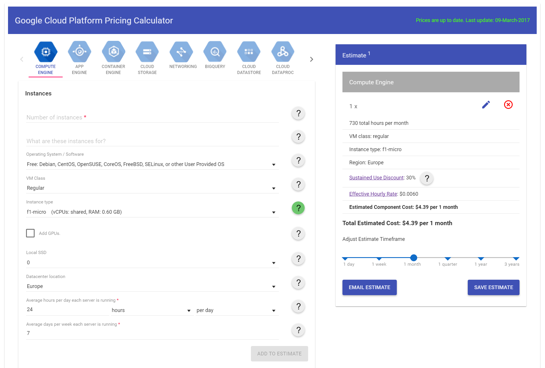

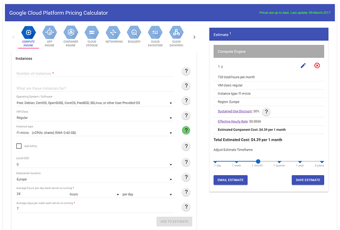

Will the openhab-cloud server work with Google’s cheapest version of their compute engines with only 0.6 GB RAM?
I’m not the developer so I’m not really sure what they’re doing here but I see no reason why it can’t be done. I created an issue for it.
I would assume so, mine is currently only using 174M ram and no cpu.
