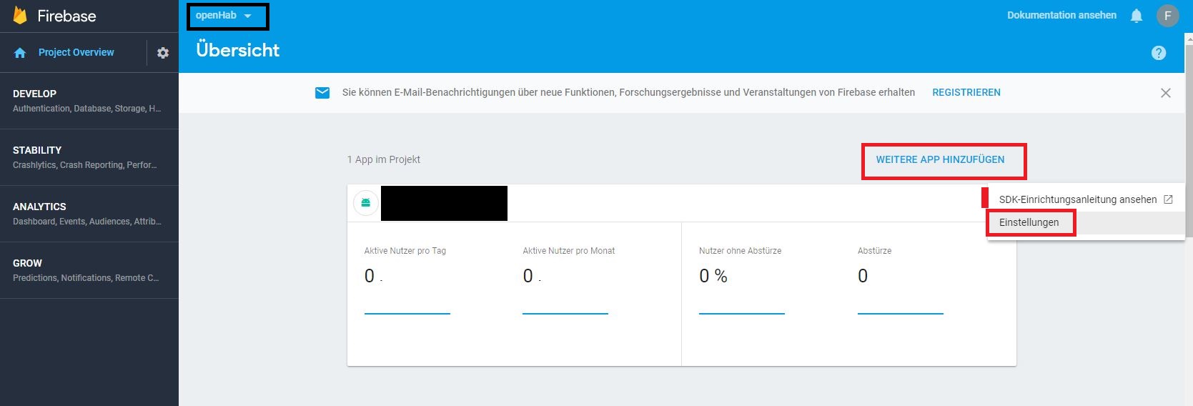

Can someone point me to the right buttons for step “add a mobile app”?
Thx
Stefan
Hi Stefan,
sorry for the late answer.
I have no idea how to describe it in a better way.
Open: https://console.firebase.google.com/ → add Project → add App → open properties
Maybe the following picture will help you?
