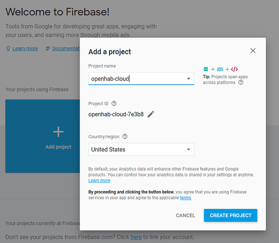

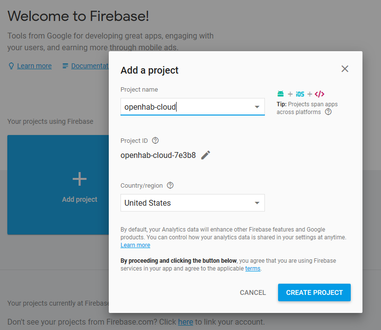

  2. add a new project and assign a name of your choice (not sure if it’s important to set the correct region, but I selected Germany for myself)

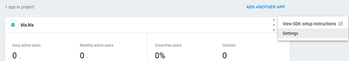

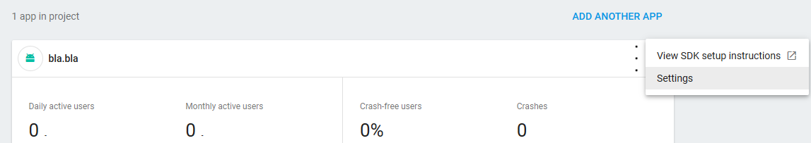

  4. Enter any dummy package name like bla.bla and click on register App button (afterwards some more hints will be shown in the popup window, just close it)
  5. Click on the three dots followed by Settings

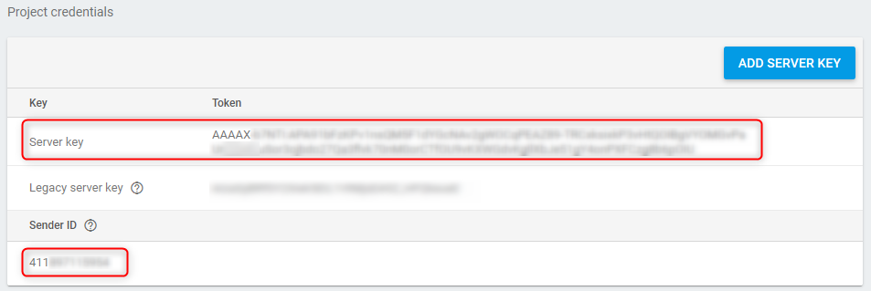

  7. copy / paste the server key (=password) and sender id (=jid) to your config file (see next step).
    Important: Please note that you will need to add @gcm.googleapis.com to your sender id (people have reported that @googleapis.com works as well for them, but I use it with the gcm subdomain)

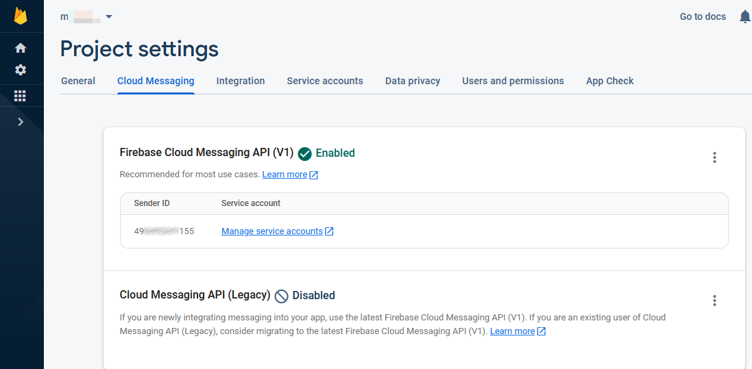

I’m struggeling with the new user interface of Firebase, and the deprecation of the cloud Messaging API.
Could someone please help me and tell me, how to get the jid and password for the config.json?
The user interface looks as following:
EDIT: I found out, that you can enable the Cloud messagaging API (legacy) by clicking on the three dots right of it.
