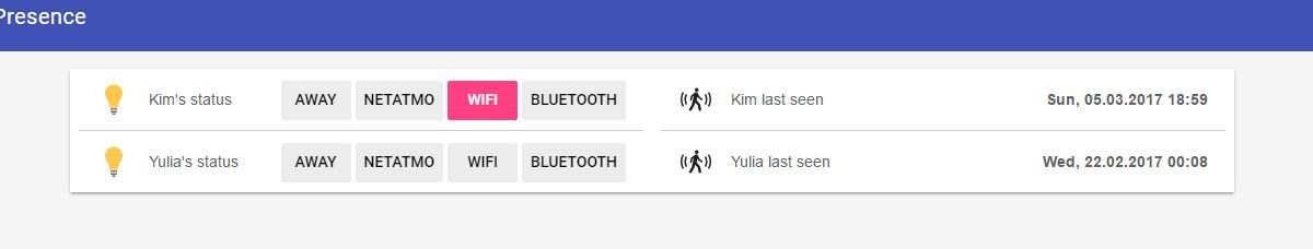

Several button pressed in GUI on 1 line
I would like the buttons to be activated to tell me what kind of presence that are detected, so if my phone is on WIFI and Bluetooth I want both items to lit up, is this somehow possible in OH2?

Not possible. Only one can be highlighted at a time in Basic UI, Classic UI and the phone apps.
There might be something clever that could be done in HABpanal but it might require custom code to make it work.
Your best bet would be to use a String Item and a Rule to put in those sensors that are ON or use multiple lines.

This gives us 7 different possible combinations, What if we make 7 images, can we get that to look nice in the GUI(scalable etc)?
Otherwise string formatting with colors might be a better solution than writng AWAY(OFF) NETATMO (ON) WIFI(ON) BLUETOOTH (OFF)
