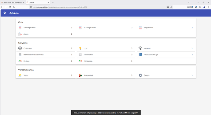

@digitaldan When opening connect in the browser I’m getting on the bottom of the screen “Offline: Waiting for connection”. When going to home I’m receiving partially on the bottom SSE-Subscription failed (see screenshots attached).
Screenshot 2026-07-04 233145
Screenshot 2026-07-04 233200
