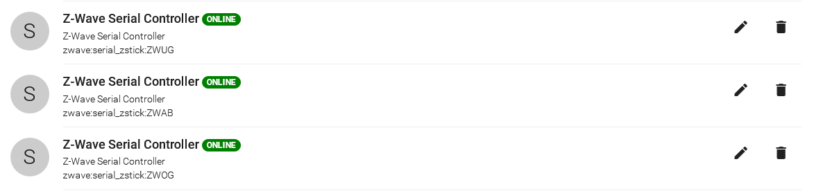

And are all controllers displayed as online? Here my screenshot from Thing configuration in PaperUI:
For the names I choose them myself (ZWOG, ZWUG, ZWAB) and do not use the cryptic proposals from OH. This makes item files easier to maintain.
Yes . default names and yes both online. One via acm0 and the other vis usb0
