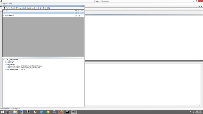

Ill get the Zensys tool tomorrow, but without resolution of the errors Ive posted above relating to the controller functioning only, I doubt much will work.
So please why do you not just connect ONLY your second controller to OH for testing, After this step you will know for sure if the second controller works and has nodes inlcuded.
Ive connected the controller to the PC but before i did, i factory reset a node (Aeotec dimmer) and the Aeotec Zstick.
Now I see this.
I plugged the stick back in and it just crashed the whole server, it automatically reset.
Ive reset the server, connected it again and nothing shows up under PaperUI inbox with the controller but the server sees it as ACM0
