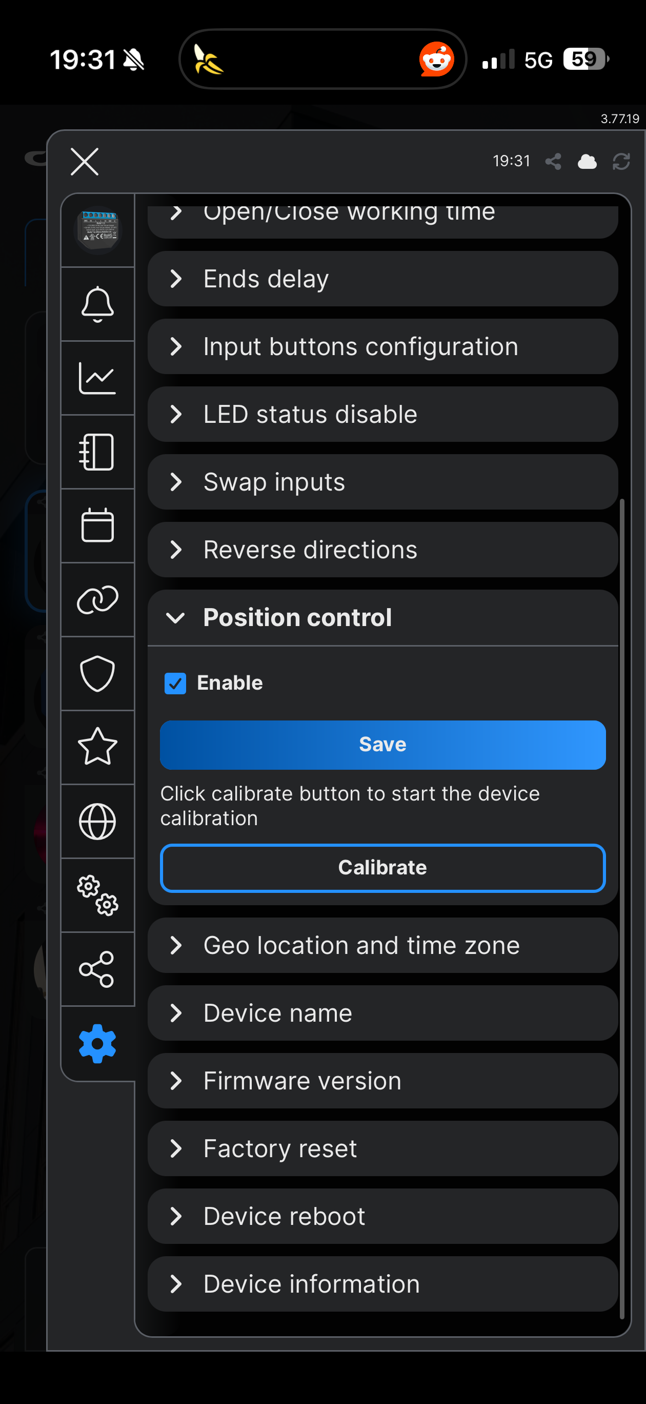

Open the Shelly app, go to settings, go to position control, and press calibrate. Wait, save, and try again.
Hi, unfortunately that did not help.
