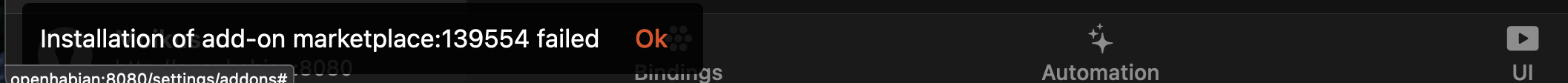

Sorry, but I get errors trying to install the binding.
ā€œInstallation of add-on marketplace:139554 failedā€.
I update/upgraded Openhab and Java to latest version. But the problem remains. After googling a lot, I could not find a solution.

@hmerk Thanks for prompt reply.
I wrote the error message in the 2nd line. → ā€œInstallation of add-on marketplace:139554 failedā€
Sorry but I’m not an advanced user. So give me a hint where I can get more useful information.
BR, Moikus

I guess automatic installation fails cause there are two versions listed.
Thanks for quick reply. I followed your steps.
Automatic installation failed again. What to do next?

Of course, you first need to uninstall the old binding version.

And please, donā€˜t try to install from marketplace after adding the .jar file to your addons folder. This is not necessary and will produce errors.

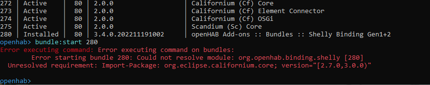

Hello everyone, unfortunately I also get an error message when starting the binding.
I think you need to update the Californium packages. After much googling, I can’t find a way to do it.

Just drop it there, openHAB will get it automatically. Please keep in mind, those bindings never show up as installed in the UI.
I do experience the same issue ā€œInstallation of add-on marketplace:139554 failedā€ unfortunately In not very experienced and I can’t solve the issue. I am also not able to download the binding https://github.com/markus7017/myfiles/blob/master/marketplace/shelly/org.openhab.binding.shelly-3.4.0M2-SNAPSHOT.jar?raw=true
I hope to get some hints
Thank you in advanced
