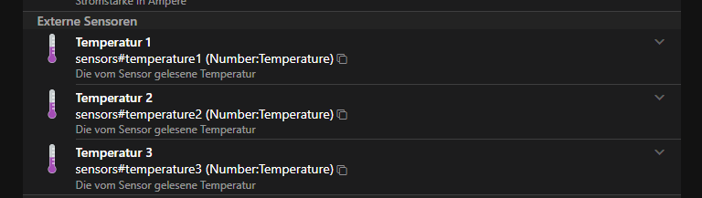

Hello, I wanted to connect a Shelly plus 1 PM with openHAB. It has an add-on with three DS18B20 temperature sensors.
The Shelly was found via Thing Scan. It found 3 channels for external temperature.
If I now want to link the temperature items, it is like a random generator which sensor I get. Sometimes sensor (100) sometimes sensor (101). But I never get the sensor that matches the item.
The Thing goes to “error communication” “websocket error” in the meantime and has to be switched on and off again.
The following messages are displayed in the Shelly diagnosis, which I have not yet been able to explain.
Shelly Firmware 1.2.0
OpenHAB 4.4.1 with Shelly Binding 4.4.1
helly_notification:116 ch type=WS_in info=192.168.178.22:56568 has no DST
18:30:00
shelly_notification:116 ch type=WS_in info=192.168.178.22:43900 has no DST
18:30:00
shelly_notification:163 Status change of temperature:101: {"id":101,"tC":17.44,"tF":63.39}
18:30:15
shelly_notification:116 ch type=WS_in info=192.168.178.22:56568 has no DST
18:30:15
.22 is the OpenHAB Server
I will probably switch to MQTT until the problem is solved.
