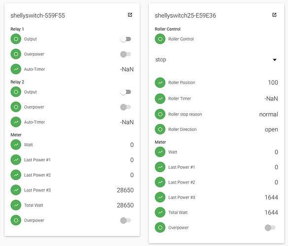

This is the first build, which provides regular functions
  • Shelly 1
    not tested, but should work as the Shelly 2 limited to 1 relay
  • Shelly 1PM
    not tested
  • Shelly 2 - relay mode
    turn the output
    meter reading
    read overpower flag
    open: send relay events to a trigger channel
    open: need to check the auto timer, sees like incorrect documentation
  • Shelly 2 - roller mode
    turn the roller
    set roller position
    meter reading
    read overpower flag
    get stop state (incl. obstacle detection)
    open: there are some channels, which doesn’t get updated properly
    open: need to check the timer, sees like incorrect documentation
  • Shelly HT
    discovery should work
    currently no channels, will be added soon
  • Shelly Bulb, Sense, RGW2
    not yet supported
Please make sure to delete ALL things before installing the new version (thing definitions have changed). If the things get not discovery immediately be patient, wait some time and retry a manual scan - this might have to be done several times.

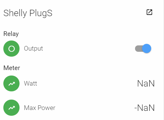

I have performed the first tests (alpha1) with a Shelly Plug S.
The discovery did not work:
2019-07-15 20:13:22.068 [WARN ] [discovery.ShellyDiscoveryParticipant] - Discovered Shelly device doesn't have an IP address: [ServiceInfoImpl@10810566 name: 'shellyplug-s-376D1F._http._tcp.local.' address: '(null):0' status: 'DNS: JmDNS-/192.168.2.80 [/192.168.2.80] state: probing 1 task: null', has NO data
        shellyplug-s-376D1F._http._tcp.local.: ]
2019-07-15 20:13:22.080 [INFO ] [discovery.ShellyDiscoveryParticipant] - Shelly device discovered: IP-Adress=192.168.2.73, name=shellyplug-s-376d1f
2019-07-15 20:13:22.266 [DEBUG] [helly.internal.handler.ShellyHandler] - Shelly settings info : {"device":{"type":"SHPLG-S","mac":"CC50E3376D1F","hostname":"shellyplug-s-376D1F","num_outputs":1,"num_meters":1},"wifi_ap":{"enabled":false,"ssid":"shellyplug-s-376D1F","key":""},"wifi_sta":{"enabled":true,"ssid":"Ankh-Morpork","ipv4_method":"static","ip":"192.168.2.73","gw":"192.168.2.1","mask":"255.255.255.0","dns":"192.168.2.1"},"wifi_sta1":{"enabled":false,"ssid":null,"ipv4_method":"dhcp","ip":null,"gw":null,"mask":null,"dns":null},"mqtt": {"enable":false,"server":"192.168.33.3:1883","user":"","reconnect_timeout_max":60.000000,"reconnect_timeout_min":2.000000,"clean_session":true,"keep_alive":60,"will_topic":"shellies/shellyplug-s-376D1F/online","will_message":"false","max_qos":0,"retain":false,"update_period":30},"sntp": {"server":"time.google.com"},"login":{"enabled":false,"unprotected":false,"username":"xxxx","password":"xxxx"},"pin_code":"xxx","coiot_execute_enable":true,"name":"","fw":"20190711-084501/v1.5.0-hotfix4@3b4f7414","build_info":{"build_id":"20190711-084501/v1.5.0-hotfix4@3b4f7414","build_timestamp":"2019-07-11T08:45:01Z","build_version":"1.0"},"cloud":{"enabled":true,"connected":true},"timezone":"Europe/Berlin","lat":50.110901,"lng":8.682130,"tzautodetect":true,"time":"20:13","hwinfo":{"hw_revision":"prod-190325-test","batch_id":1},"max_power":2500,"led_status_disable":true,"led_power_disable":false,"relays":[{"ison":true,"has_timer":false,"overpower":false,"default_state":"off","auto_on":0.00,"auto_off":0.00,"btn_on_url":null,"out_on_url":null,"out_off_url":null,"schedule":true,"schedule_rules":["1730-0123-on","2350-0123456-off","0800-456-on"]}],"meters":[{"power":3.68,"is_valid":true,"timestamp":1563221602,"counters":[3.690, 3.693, 3.677],"total":11145}]}
2019-07-15 20:13:22.296 [ERROR] [discovery.ShellyDiscoveryParticipant] - Device discovery failed: java.lang.IllegalStateException: Expected BEGIN_OBJECT but was STRING at line 1 column 1550 path $.relays[0].schedule_rules[0]
2019-07-15 20:13:23.912 [WARN ] [discovery.ShellyDiscoveryParticipant] - Discovered Shelly device doesn't have an IP address: [ServiceInfoImpl@6255384 name: 'shellyplug-s-376E9E._http._tcp.local.' address: '(null):0' status: 'DNS: JmDNS-/192.168.2.80 [/192.168.2.80] state: probing 1 task: null', has NO data
        shellyplug-s-376E9E._http._tcp.local.: ]
Adding the device manually worked.
I have create one switch item for power on and off and another number item to display the current watts.
Switching the plug on and off works. The display of the power does not work (shows only “NaN”). This is the trace output:
Shelly status info : {"wifi_sta":{"connected":true,"ssid":"Ankh-Morpork","ip":"192.168.2.72","rssi":-49},"cloud":{"enabled":true,"connected":true},"mqtt":{"connected":false},"time":"20:03","serial":1627,"has_update":false,"mac":"CC50E3376EAF","relays":[{"ison":true,"has_timer":false,"overpower":false}],"meters":[{"power":5.50,"is_valid":true,"timestamp":1563221014,"counters":[5.384, 6.031, 6.089],"total":8076}],"temperature":31.71,"overtemperature":false,"update":{"status":"idle","has_update":false,"new_version":"20190711-084501/v1.5.0-hotfix4@3b4f7414","old_version":"20190711-084501/v1.5.0-hotfix4@3b4f7414"},"ram_total":50832,"ram_free":37512,"fs_size":233681,"fs_free":176202,"uptime":336312}

Shelly Plug S can be switched on and off (display of Watt and also Max Power) don’t work:
