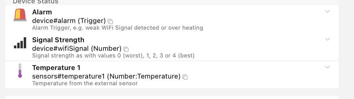

Relevant messages when in switch mode
2023-09-24 19:36:20.445 [DEBUG] [y.internal.handler.ShellyBaseHandler] - shellyplus2pm-c049ef8b2474: Shelly Add-On detected with at least 1 external sensor
2023-09-24 19:36:22.667 [DEBUG] [g.shelly.internal.api2.Shelly2ApiRpc] - shellyplus2pm-c049ef8b2474: NotifyStatus update received: {"id":1719399656,"src":"shellyplus2pm-c049ef8b2474","dst":"shellyplus2pm-c049ef8b2474","params":{"ble":null,"cloud":{"connected":false},"mqtt":{"connected":false},"sys":{"mac":"C049EF8B2474","restart_required":false,"time":"19:36","unixtime":1695573382,"uptime":86,"ram_size":257964,"ram_free":112932,"fs_size":458752,"fs_free":143360,"cfg_rev":10,"available_updates":null,"webhook_rev":2},"wifi":{"sta_ip":"192.168.10.230","status":"got ip","ssid":"HomeAuto","rssi":-46},"input:0":{"id":0,"state":false},"input:1":{"id":1,"state":false},"switch:0":{"id":0,"source":"init","output":false,"apower":0.0,"voltage":227.6,"current":0.0,"pf":0.0,"aenergy":{"total":0.0,"by_minute":[0.0,0.0,0.0],"minute_ts":1695573380},"temperature":{"tC":67.0,"tF":152.6}},"switch:1":{"id":1,"source":"init","output":false,"apower":0.0,"voltage":227.7,"current":0.0,"pf":0.0,"aenergy":{"total":0.0,"by_minute":[0.0,0.0,0.0],"minute_ts":1695573380},"temperature":{"tC":67.0,"tF":152.6}},"temperature:100":{"id":100,"tC":32.8,"tF":91.1}},"result":{"ble":{},"cloud":{"connected":false},"mqtt":{"connected":false},"sys":{"mac":"C049EF8B2474","restart_required":false,"time":"19:36","unixtime":1695573382,"uptime":86,"ram_size":257964,"ram_free":112932,"fs_size":458752,"fs_free":143360,"cfg_rev":10,"available_updates":{},"webhook_rev":2},"wifi":{"sta_ip":"192.168.10.230","status":"got ip","ssid":"HomeAuto","rssi":-46},"input:0":{"id":0,"state":false},"input:1":{"id":1,"state":false},"switch:0":{"id":0,"source":"init","output":false,"apower":0.0,"voltage":227.6,"current":0.0,"pf":0.0,"aenergy":{"total":0.0,"by_minute":[0.0,0.0,0.0],"minute_ts":1695573380},"temperature":{"tC":67.0,"tF":152.6}},"switch:1":{"id":1,"source":"init","output":false,"apower":0.0,"voltage":227.7,"current":0.0,"pf":0.0,"aenergy":{"total":0.0,"by_minute":[0.0,0.0,0.0],"minute_ts":1695573380},"temperature":{"tC":67.0,"tF":152.6}},"temperature:100":{"id":100,"tC":32.8,"tF":91.1}}}
2023-09-24 19:36:22.697 [DEBUG] [y.internal.handler.ShellyBaseHandler] - shellyplus2pm-c049ef8b2474: Adding channel sensors#temperature1
As you can see temperature sensor channel is created

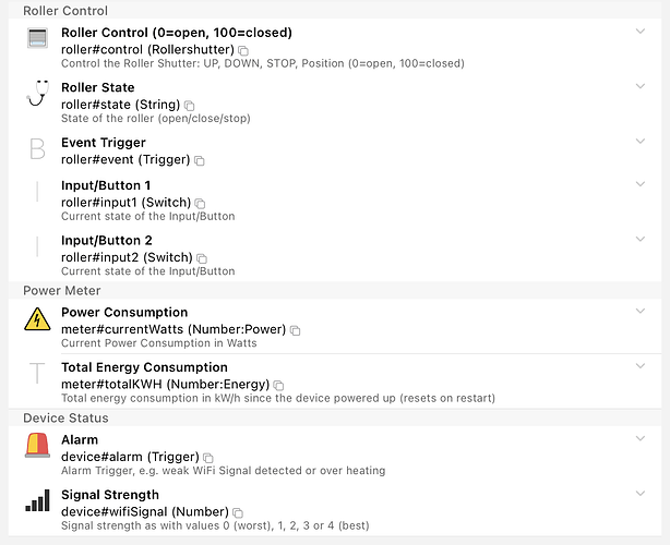

Relevant messages when in cover mode
2023-09-24 19:43:58.649 [DEBUG] [y.internal.handler.ShellyBaseHandler] - shellyplus2pm-c049ef8b2474: Shelly Add-On detected with at least 1 external sensor
2023-09-24 19:44:00.890 [DEBUG] [g.shelly.internal.api2.Shelly2ApiRpc] - shellyplus2pm-c049ef8b2474: NotifyStatus update received: {"id":212392860,"src":"shellyplus2pm-c049ef8b2474","dst":"shellyplus2pm-c049ef8b2474","params":{"ble":null,"cloud":{"connected":false},"mqtt":{"connected":false},"sys":{"mac":"C049EF8B2474","restart_required":false,"time":"19:44","unixtime":1695573840,"uptime":43,"ram_size":257688,"ram_free":109772,"fs_size":458752,"fs_free":143360,"cfg_rev":11,"available_updates":null,"webhook_rev":3},"wifi":{"sta_ip":"192.168.10.230","status":"got ip","ssid":"HomeAuto","rssi":-42},"input:0":{"id":0,"state":false},"input:1":{"id":1,"state":false},"cover:0":{"id":0,"source":"init","state":"stopped","apower":0.0,"voltage":226.6,"current":0.0,"pf":0.0,"aenergy":{"total":0.0,"by_minute":[0.0,0.0,0.0],"minute_ts":1695573840},"pos_control":false,"temperature":{"tC":66.9,"tF":152.5}},"temperature:100":{"id":100,"tC":32.8,"tF":91.1}},"result":{"ble":{},"cloud":{"connected":false},"mqtt":{"connected":false},"sys":{"mac":"C049EF8B2474","restart_required":false,"time":"19:44","unixtime":1695573840,"uptime":43,"ram_size":257688,"ram_free":109772,"fs_size":458752,"fs_free":143360,"cfg_rev":11,"available_updates":{},"webhook_rev":3},"wifi":{"sta_ip":"192.168.10.230","status":"got ip","ssid":"HomeAuto","rssi":-42},"input:0":{"id":0,"state":false},"input:1":{"id":1,"state":false},"cover:0":{"id":0,"source":"init","state":"stopped","apower":0.0,"voltage":226.6,"current":0.0,"pf":0.0,"aenergy":{"total":0.0,"by_minute":[0.0,0.0,0.0],"minute_ts":1695573840},"pos_control":false,"temperature":{"tC":66.9,"tF":152.5}},"temperature:100":{"id":100,"tC":32.8,"tF":91.1}}}
But sensor temperature channel never added
(no it is not showing if show advanced is clicked either)
