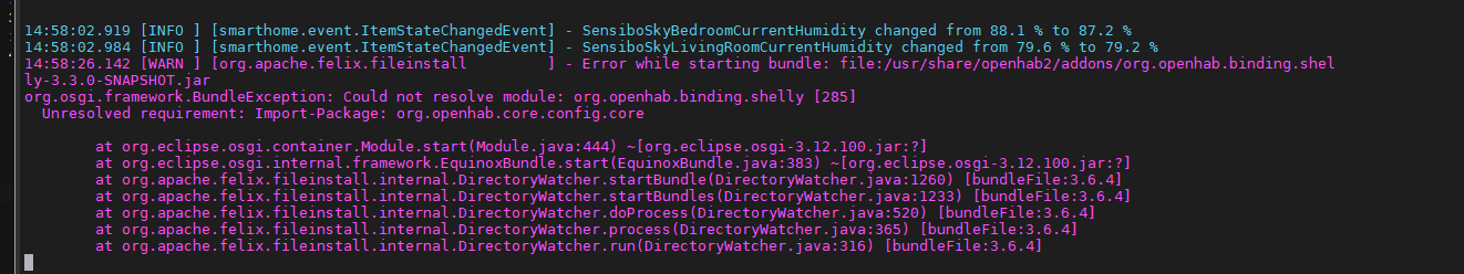

hello,
I have this error while loading the system:
what can be done?
Did you installed the Californium jars, check READMEbeta.md

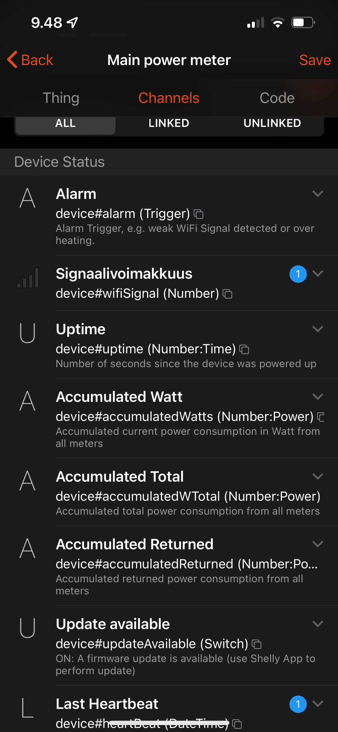

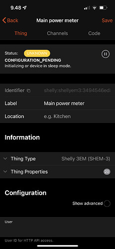

Hi I am just trying out the shelly binding on openHAB 3.2.0 stable.
I have the following issues with Shelly 3EM
  • thing does not expose the channels for phase A, B and C, as advertised in the docs. There is only the “device” channel group but no “meter1” channel group for example. Shelly - Bindings | openHAB
  • thing stays in yellow, pending configuration. What could be the reason?
I added the thing via discovery, seemed to be a smooth message.
I am quite new to this binding so this might be a user error as well.

The thing has to complete initialization before you see all channels. CONFIG_PENDING means that init is not completed; what status message is shown when you click on the thing?
