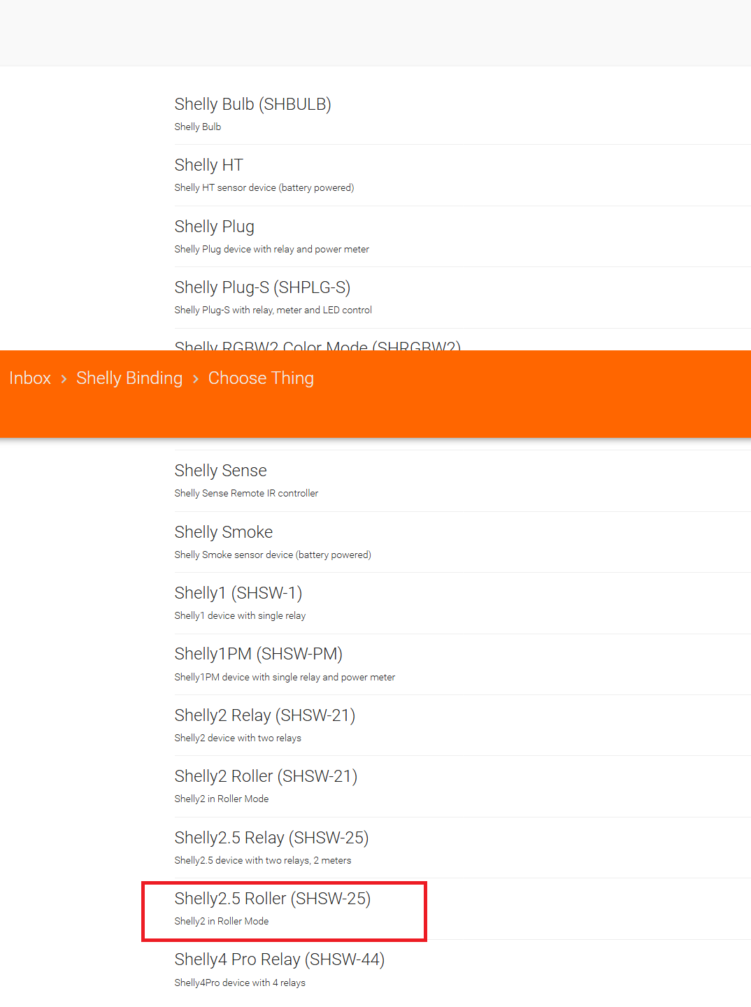

Lots of thanks for your work. I have downloaded shelly binding jar and openhab did recognize my only shelly 2.5, until I install a couple more. I don`t know how to help the developer ( give me hint ) if necessary. At the very moment I only have a question: How can I get Openhab recognize my shelly 2.5 as a roller shutter? I must say it is not deployed as roller shutter, but as two independent swichtes.
in the manual way, when adding the thing choose
Thank you very much. I forgot looking at all options at the bottom of the list. I will try as I installed on a two-way system or a roller-shutter.
you could select the operation mode (Relay/Riller) within the Shelly App, this will be recognized by the binding while discovering the device. If you change the mode after initial discovery you need to delete the thing and re-discover
