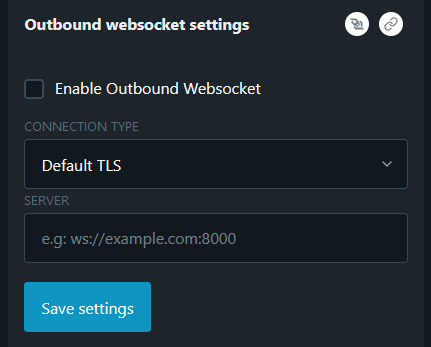

I’d like to statically configure the outgoing websocket configuration on the device. What would I have to enter? Is there a config flag to indicate that this has been set so it can be skipped during initialization?
