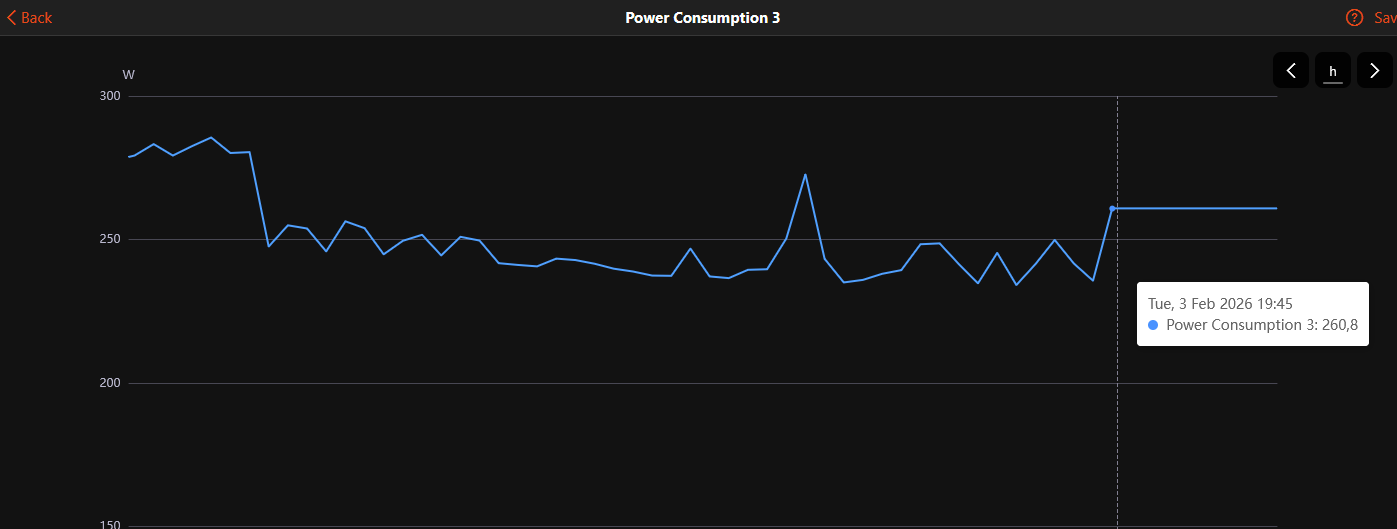

Exactly what I wrote @chuck2k , that new web ui update and switching from mono phase to three phase and then back to mono phase seems to have sorted it out.
I’m as dumbfounded as you honestly.
but switching back to monophase stops update measurements for Power Meter 3, isn’t it?
@chuck2k , no no, I believe that having mono phase without the third sensor was a bug that got sorted once I switched from mono to three phase and then back to mono phase.
Try to do that → change to three phase → change back to mono and check the number of sensors now detected.
After changing to mono, all items of Power Meter 3 are not updated anymore. Your theory is wrong.
I need to finish working on 3 important PRs, then I could lool into that
well. Shit. Thank you for insisting because I was looking at the wrong item.
I can confirm that my third channel is also not working… I know for a fact that when I wrote (in GitHub) about this it had gotten fixed.
So yeah, I don’t have any values on the third channel like you and I’ve been wrong all this time o.o and the total energy consumption is stuck at zero.
Tag me whenever you have the availability and I’ll join the testing :slight_smile: (or just do a random post, I’m following you anyway haha)
