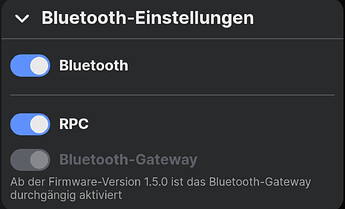

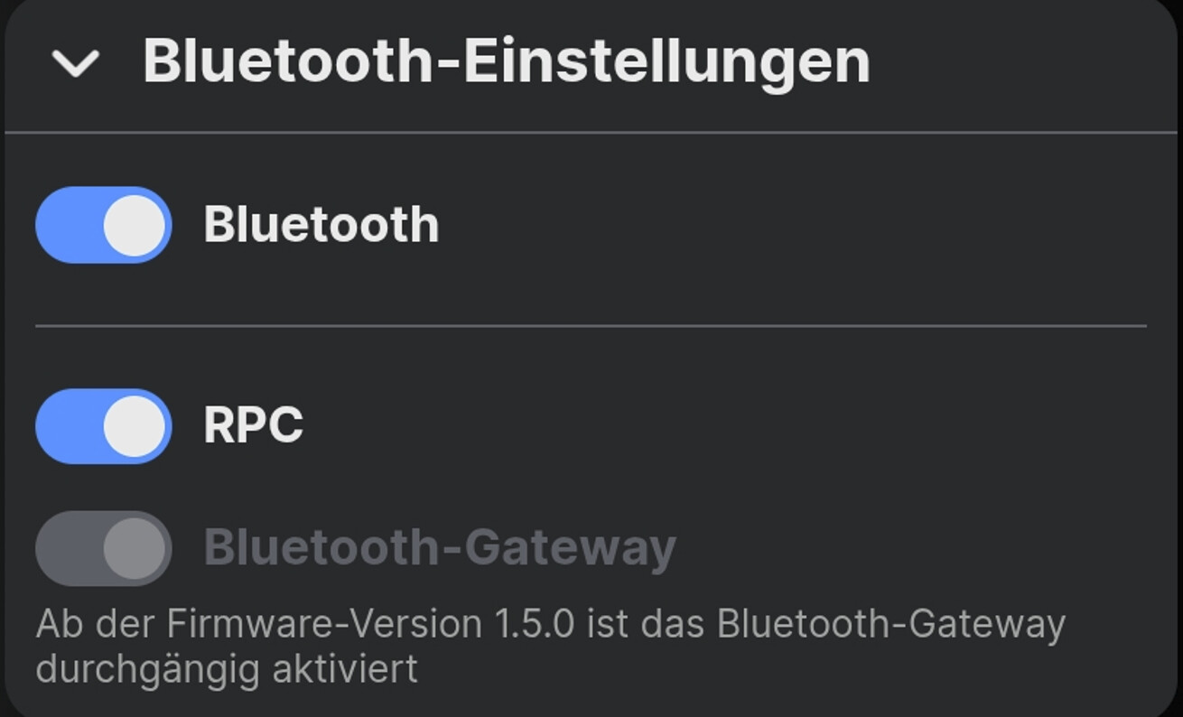

HI all,
I found in the documentation of the Shelly binding that the bluetooth gateway mode needs to be disabled either through the device UI or through the Shelly app to make the oh-blu-scanner.js running properly on the device to make paired Shelly BLU devices visible in OH.
I am running OpenHAB 5.1.1 in a docker container on my NAS.
I am using a Shelly Plus 1 Mini Gen3 as a bluetooth gateway for my Shelly BLU button. My Shelly device is on firmware level 1.7.5-g99…
On that firmware level there is no option to activate or deactivate the gateway function via the UI. Hence, I registered my Shelly Plus 1 Mini device via cloud in the Shelly app and found in the bluetooth settings that the switch to turn off the gateway mode is greyed out and there is a message that since firmware level 1.5.0 the gateway mode is consistently activated and cannot be turned off anymore (see screenshot)
Can you please advise if and how I can now connect my BLU button when the gateway mode cannot be turned off anymore?
I have tried adding it trough the OpenHAB UI and it hangs like expected in CONFIGURATION_PENDING (see screenshot) as the script hangs.
P.S. All my Shelly devices are on a higher firmware level than 1.5.0. This would imply that I cannot attach them to OpenHAB. I cannot believe that this can be true.
Thanks for any hint and support.

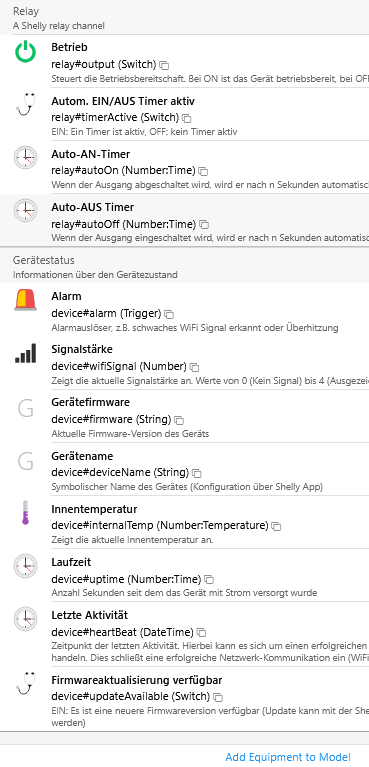

Hi, I have 3 Shelly Plug S Gen 3 with Firmware 1.7.3.
They are auto-detected by the binding as “shellyplusplug”, but with missing channels - no power measurements.
Any ideas? Shouldn’t power/energy channels show up and work?
According to the docs, there should be a meter group which is missing here.
