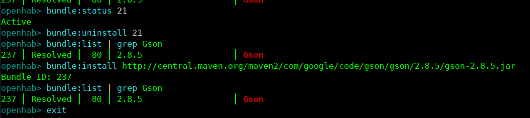

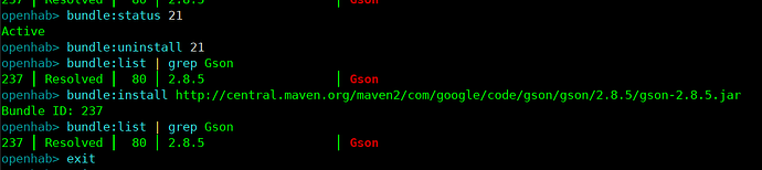

I can confirm that copying the gson-2.8.5.jar in the addon folder makes everything survive a clean-cache in my OH 2.4 env.
ok, that makes way more sense than the bundle:install

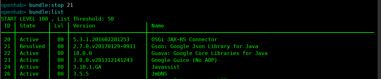

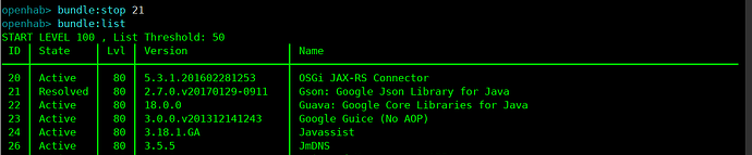

snapshot.2.5.jar works fine on OH 2.4 with GSON 2.7 ( power object work )
i had stopped for first time gson 2.7 and installed 2.8
but on second time i removed gson 2.7 and reinstalled 2.8,
but after reboot reappear gson 2.7
7_autoreinstalled_2019-12-0420-21-59
Strange… But does work.
