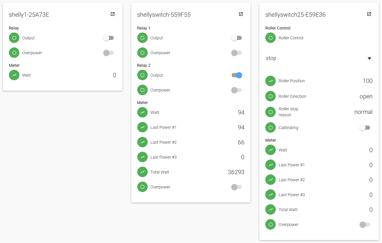

after powering up my Shelly1 I have to report that it’s not running. I fixed a bug related to device discovery, but processing the relay status to update the channels doesn’t work yet. I keep you posted
ok, here is alpha3
https://github.com/markus7017/org.openhab.binding.shelly/blob/alpha3/target/org.openhab.binding.shelly-2.4.0-SNAPSHOT.jar
  • fix for the “Not found” in Paper UI when adding the Shelly2-roller (duplicate channel)
  • support for Shelly1 - it’s not “a half Shelly2”, it’s specific
  • avoid exception on thing discovery
again you need to remove and re-add all things and clean out the JSON DB
Shelly 1, 2, 2.5 look good for me
feedback on other devices welcome

Here are my test results:
  • Bulb: white bulb and my Plug S are now detected automatically
  • Bulb: changing the brightness of the bulb in Paper UI has no effect
  • Bulb: effect can not be changed. it shows only “-” in Paper UI
  • Bulb: Color Bulb can be added manually. Changing the values e.g. for the colors has no effect
  • Plug S: display of watts and power shows nAn (BTW: after adding an item for the bulb brightness it showed also “NaN” but the widget in Paper UI could be changed to a different value. There seems to be a general problem with numeric values.

Please find alpha4 in the repo:
https://github.com/markus7017/org.openhab.binding.shelly/blob/alpha4/target/org.openhab.binding.shelly-2.4.0-SNAPSHOT.jar
@igi helped me a lot with testing , so we could make significant progress - thanks Igi!!!
  • fix: thing type id for shelly2-plug-s fixed, so now you get the full set of Meter channels
  • fix: Meter channels for Plug S get filled, thing definition corrected
  • fix: Avoid exception on invalid number format ($power)
  • fix: Avoid exception on event callback
  • new: seperate thing types for Shelly2 and Shelly2.5 - the 2.1 has 1 meter, the 2.5 has 2
  • new: added a 2nd Meter to the Shelly 2.5 relay channels so both meters are accessible
  • new: meter data is accumulated when in roller mode (mapping 2 to 1 meter)
  • new: timestamp channel added to meters
  • new: output firmware version to the log (and thing properties)
  • new: check for FW > 1.5 (that’s the minimum version, I don’t want to provide backward compatibility to older releases)
  • change: Thing gets online after the status was successfully updated for the first time, not at initialization time
  • change: COAP usage disabled until I understand how to initialize for observing non-standard options
Shelly2/2.5 things:
Given the diffrent set of meaningful channels and the difference in the number of meters (Shelly2: 1, Shelly2.5: 2) this results in 4 different thing types:
shelly2-relay: 2 relay, 1 meter
shelly2-roller: 1 roller, 1 meter
shelly25-relay: 2 relay, 2 meter
shelly25-roller: 1 roller, 1 meter (kumuliert aus beiden Meter, timestamp = newest measurement)
Known issues:
  • Shelly Plug S: Status updates on LED control channel
  • Shelly RGBW2 is not yet finally implemented
  • Progress on the Shelly Bulb is made, but still work in progress
  • The polling frequencyneeds to be optimized by utilizing the event callback when sensor data has changed
  • The event trigger channel is not yet implemented - this will trigger a notification to an OH rule each time an event is received
  • http authentication is currently not implemented, this means you have to disable http auth for the build-in web server
  • The binding starts one update thread per device, this needs to be consolidated making the device handling more efficient
Some channels might be missing, some need some fixes. If you see something post on the forum or send me a PM inlc. TRACE log for bugs.
