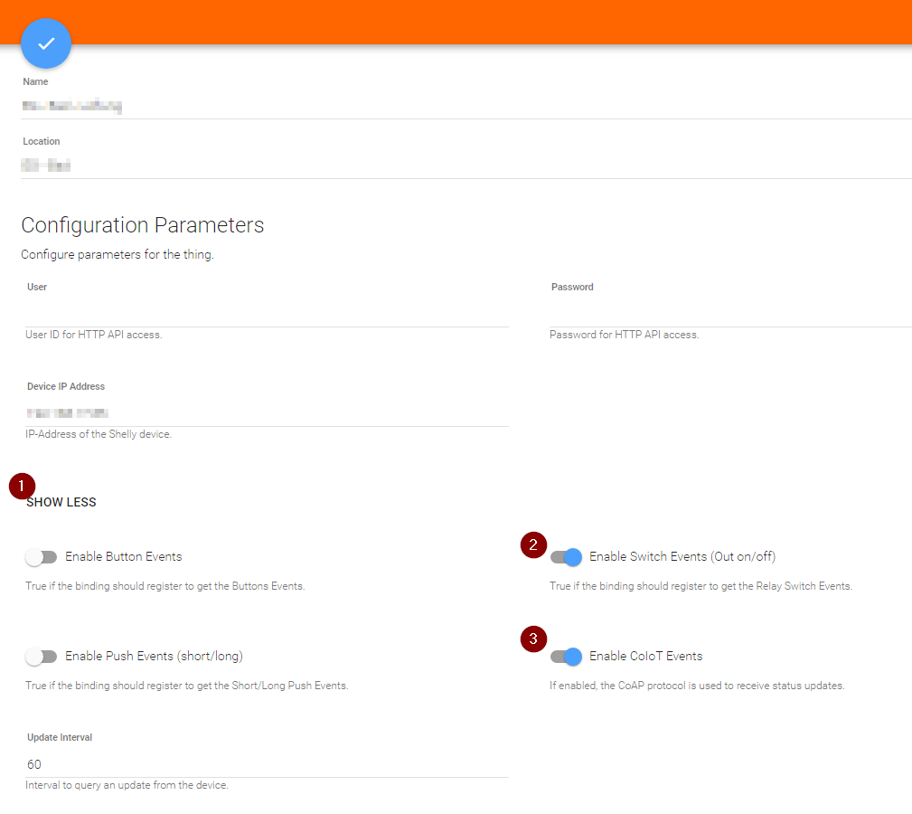

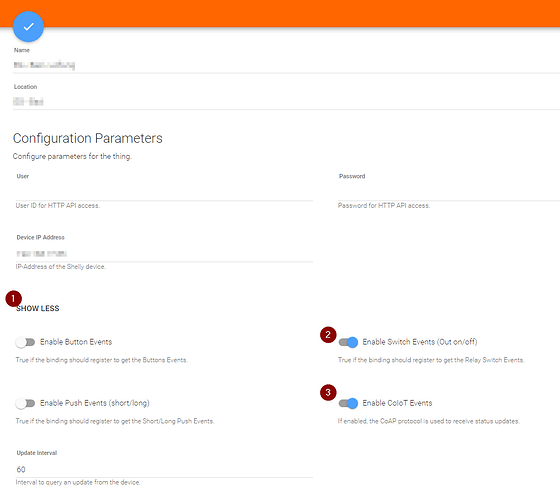

I had the same Problem. By me was that “Enable Switch Events” was not set:
With this settings it works perfect.
By one switch it not works. After I also had activate “Enable Buttons-Events” → Only then it works.
