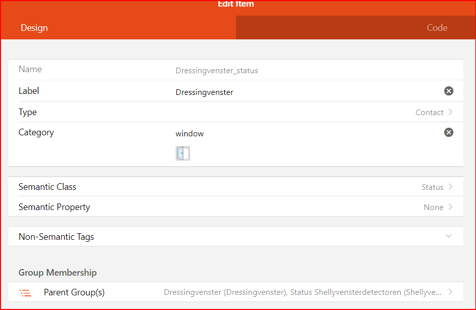

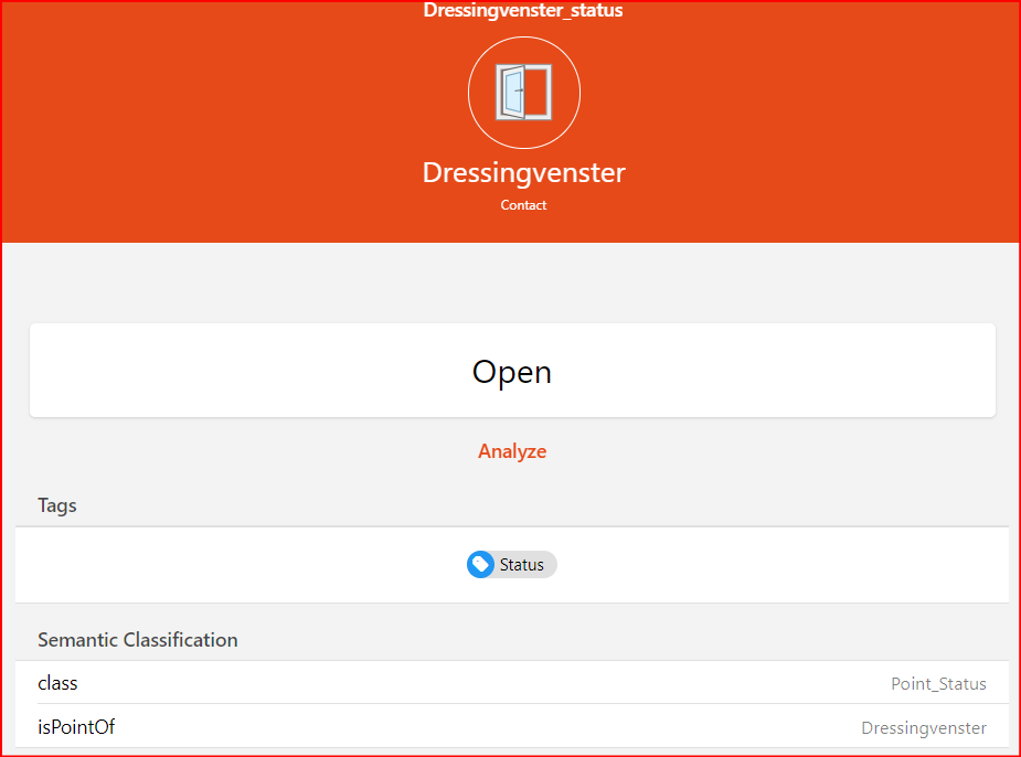

Gives this in openHAB:
Under the hood
label: Dressingvenster
type: Contact
category: window
groupNames:
  - Dressingvenster
  - Shellyvensters_status
tags:
  - Status

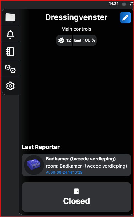

It does have a live “heartbeat”:
I’ve got another Shelly BLU Door/Window connected to the same Shelly 1 Mini. I tried rebooting this Shelly 1 Mini from Shelly’s app, I tried disabling and re-enabling this Shelly 1 Mini in openHAB. I tried disabling and re-enabling both window sensors in openHAB.
I can’t reboot the window sensors, because I can’t reach the physical button for the moment.
But earlier this week, I had the same problem with another Shelly BLU Door/Window, and rebooting it didn’t do the trick. Then, disabling and re-enabling the Shelly Plus 1 PM it is connected to, worked. But now apparently, that’s not enough.

Now I can’t re-enable the other sensor in openHAB:
I keep pressing the button on the sensor, but to no avail…
Eventually, the thing went online again. Maybe opening/closing the window was a trigger?
Badkamervenster now works as it should again… I tried the same with Dressingvenster. It also only got online again after closing or opening the window (I once again couldn’t reach the button). But unlike Badkamervenster, Dressingvenster doesn’t really come alive: it doesn’t record new state changes (or lux changes for that matter).
